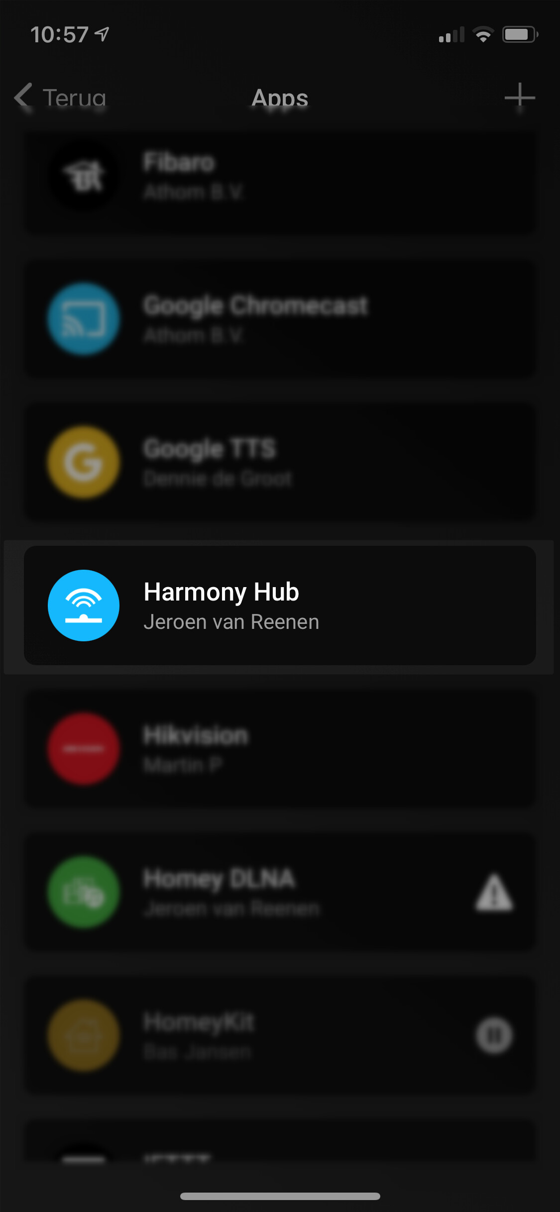

In the homey app go to more and touch Apps
From the app list touch Harmony Hub

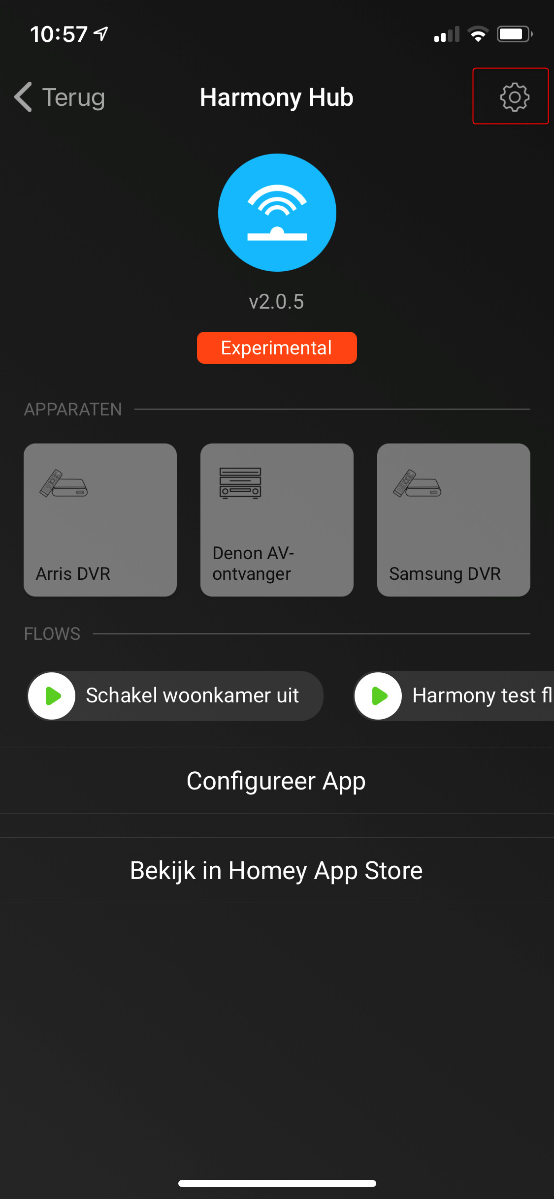

Touch the wrench on the top right corner
Touch the button stating create a diagnostic report (or something similair)
Type a short description and send in the report
This should give me a bit more information to work from, thanks in advance!
