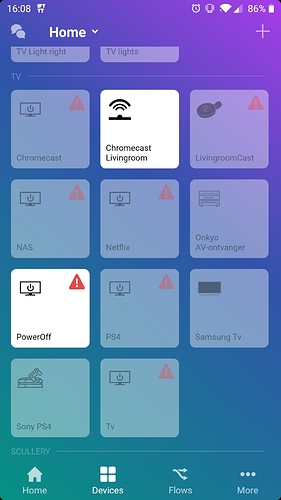

With the new version i have the following problem:
If i click on one of the problem devices it says “Device is unavailable , the hub went offline”
My Samsung device , receiver & playstation show the controls normal.
Hi @Lars_Faber
Will investigate this. Do you have 1 or multiple hubs? Does this problem only occurs on activity devices?

I also can control the TV from the app, but i can’t start the activity “Poweroff”, i then got the error message “Hub offline”.
Looks like the problem is only in the activity’s.

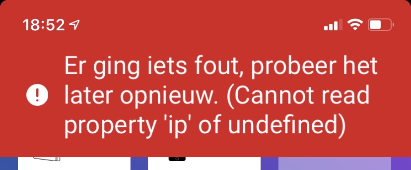

Can confirm, had to add my activities again also.
@jreenen the app cannot find the hub anymore since they last update. I completely reinstalled the app, no success.
seems to be oke and working again
@Paul_Kessels Could you try powering off the hub and plug it back in?
@jreenen
Yes, tried that, also restarted the app after the reboot. Still cannot find the hub.
I believe the idea was mentioned before, but being able to manually enter the ip address of the hub would be a great solution.
Or what Else can i try?

Hmm, spoke too soon… The PowerOff in my media room is working as instended but the one in the living room does not work at all.
The PowerOff device in Homey in my living room hub does nothing at all. It doesnt change state and nothing happens if I klick on it in the Homey app.
@ktd You probably already did but just to be sure: have you removed and re-added the power-off activity devices?
I didn’t have it installed since I had made a workaround. So I added the PowerOff just before I tried the update today.
But I can try to remove and re-add it.
Edit
Just tried and the PowerOff is dead on this hub.
