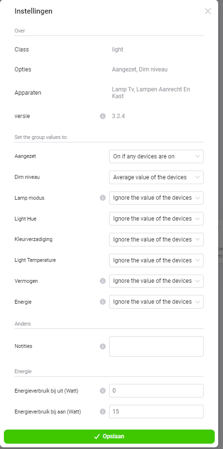

All my groups are made in app version 3.2.4
i have 2 different lamp groups, which are switched on and off with 1 other lamp group (lampen beneden)
(So i put on the last group, all the other groups are turned on. See first picture)
When i delete the “lamp TV Group” and make a new one, i get the error message when i want to add the new group to the “lampen beneden”
Error message, see last picture
So now i have to delete the group “lampen beneden” and make it again.

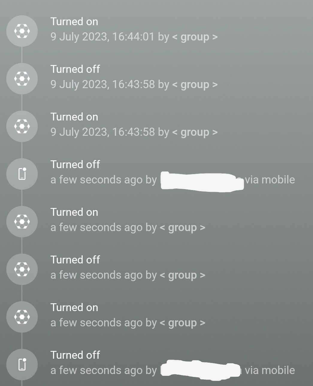

c3b0b20c-53e4-41a5-8d49-8f634d5bd13c - I have problem with lights bouncing back when powered off via group - I have to switch every light separately to turn it off - is that anything you can fix?
Thank you
FYI - after re-creating them,it works, so probably something broken during group migration?

@Sharkys sorry that log didn’t really add any value, it didnt have any of the other changes in it, I am guessing that the screenshot you sent through is from a single light? The group app only did these actions :
First - attempted to turn off all the devices in the group (shows that only a single device from the group was actually on).
Second - Updated the group to “show” its on because a single device (same one) was also on.
16889139536 [debug] [device:All lights 🚨 on < group >] [setGroupCapabilityValue]  {

16889139536 [info] [device:All lights 🚨 on < group >] [setGroupCapabilityValue]  {
 Setting group capability: onoff to false :: [false, false, false, false, false, false, false, false, false, false, true, false, false, false, false, false, false, false, false, false, false, false, false, false, false, false](all)
At the bottom of the groups settings for the group having issues, please make sure that the logging level is set to “trace” (it might already be).
Might be useful to restart the app, wait 60 seconds, turn on the group … wait 60 seconds, toggle it - wait 60 seconds, toggle it again - then submit the report. Hopefully there will be more information in it then and I can see whats going on.
Technically it should be giving a log message whenever once of the lights in the group change state.
Maybe just also check that there are no flows setup on the group? If you have a flow which toggles a group … it will show up as the “group app” changing the state of as device … not the flow itself.

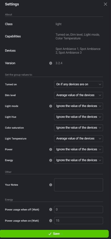

Hi Jamie,
apologies, I thought that Group name will be visible from the log, as I was trying to make maintenance on it - this is not about All lights :rotating_light: on < group > it’s actually about Living room lights < group > which is misbehaving.
Nope that’s directly from the group containing 3 lights (Spot ambience 1 + 2 + 3).
Hm, I DON’T see this option for eg. sunshades, blinds, lights, sensor, including DE-BOUNCE settings, also Logging part is missing - I see it however for classes OTHER - but basically all the rest is missing.
Even when I re-create it from scratch, it’s not there :
Is it intended that those settings are missing for other classes ?
That’s what I did actually but the *Living room lights < group > immediately turns back on, after turning off.
I don’t have any such flow unfortunately.

The group should be visible from the log, did you want to just try again? It might have just gotten lost … There have been issues with the logs recently.
Are you seeing the behaviour with all your groups, some groups or just this one group? If it is just some groups - is there a common device or class type its occurring on?
I am assuming when you recreate the group the error keep happening?
Can you try re-creating the group as a united group, (I think) that should give you some extra settings you can work with.
@ErtjeTheFreeze & @RonnyW - Yeah I really wished we could add additional items into the maintenance window and also be able to rename them.
I tested now with United, tried to add 100ms delays but seems it’s still not reliable.
Do you see now anything useful in the log ?
86cd76d4-f215-45b2-a973-e92e1e494b75
(please note I still kept the previous group as well)
That’s a question - is it enough to recreate it and keep still old one or it might be in conflict ?
Anyway, did it now - recreated the group as United group, fixed all flows and even it still blinks like the previous one, it keep lights switched off - so it works ! :wink:
