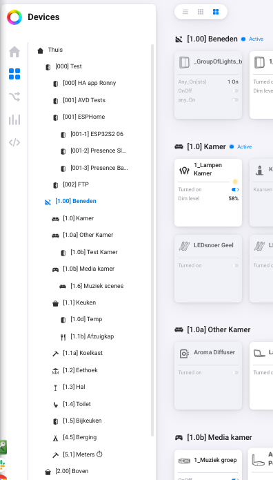

One thing, in the web app is some drag’n’drop functionality present, and right-click “move to” commands.
Sometimes the mobile app is more convenient, sometimes the web app. They also have their own options sometimes, what you can’t find @ mobile app, you can find @ web app, and v.v.
About alphabetically organizing, it’s a bit clumsy, but manually sorting the zones works better to me, when numbering them
For devices I want first or last, I put a 1 or a z as first character of the name.
To ‘hide’ devices, I put them in a zone called ‘zombie’ or z_whatever’ to list them last at the bottom
