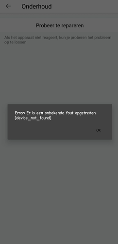

When I try to repair, I get this;
Unknown error - Device not found. … have you maybe shared Diag. Code ? Then maybe Jamie can say something. Anyway, fastest way is simply to recreate Group device from scratch and if case you have some complex flows, there is script, which you case use to fix them…(partially)
I haven’t done that yet. I don’t have many groups, so I will remake them.
