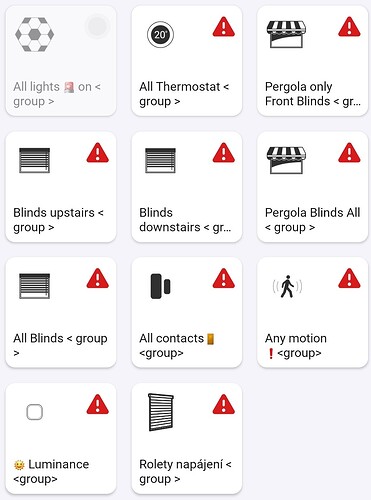

Same here, homey Pro 2019 and since the 3.1.5 update none of my groups is working anymore. 2 just stopped working, 2 stopped and show error “invalid_setting_type”.

Can you please try opening the device setting, and assigning a value to each of the capabilities then hitting save?
Also please let me know specifically what you mean by ‘not working’, does the device error, not update, show as unavailable? Can you please screen shot your settings including the version number and then finally the diagnostic report - along with the name of the device which is not working.

For me; i try to switch lamps on-off with the group but non of them response. (Gledopto, shelly, ikea)

Showing On/off but nothing happening. No error message. Same after changing values.

3.17 - the lights groups now work but blinds groups still don’t. 4b52952a-4f71-4a1d-b429-59fb1ca758bb
