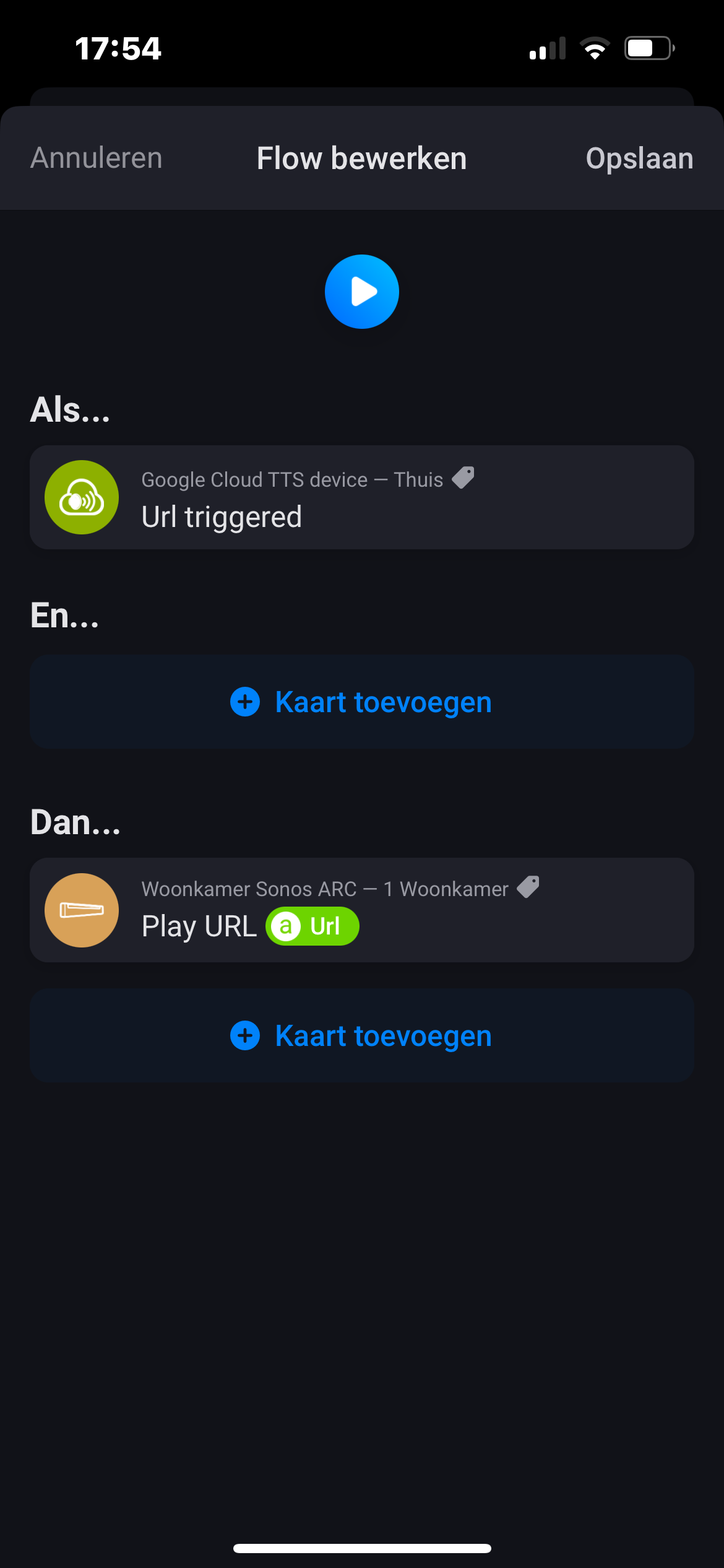

Show me the flows?
I dont have that issue, but perhaps there is a loop of somekind?
The flows are exact copies of your flows…
The message is played on the Sonos Arc.
If I am watching TV while testing this flow, the message keeps playing over and over again.
What I would like is that the sound of the tv resumes after the message.
Not sure if that is possible…

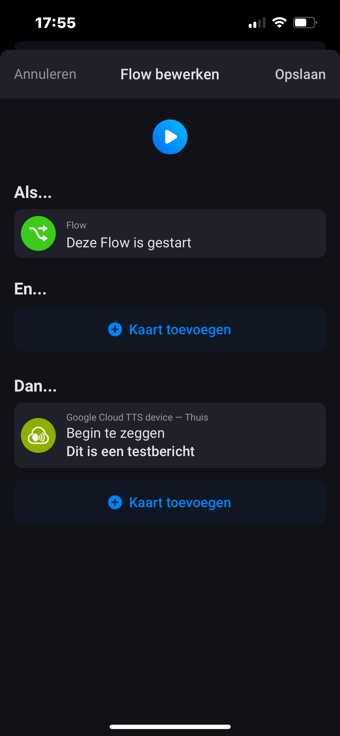

Eric
I have the same problem.
Audio keeps running until i stop the Sonos speaker.
It looks like only new flows have this problem.
Not sure if it’s the cause of this issue but when I open the TTS device while the message keeps on playing, at “tijdsduur” there is a very high number , like 800 or something.
Not sure what this “tijdsduur” means….
Do I need to set this this time somewhere in the settings?
In the screenshot it’s not there yet, because I didn’t start the flow yet.

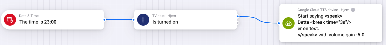

I tried the SSML coding and it works fine. But when used in the “Start saying (text) with volume gain (gain)” the gain it played with 0dB instead of the -5dB I have entered. Without SSML it plays at -5dB.
Any idea what I’m doing wrong?
Share the flow?
This is a picture of the flow. If I change the text to “Dette er en test” (this is a test) it works.
Please create a ticket and ill check it asap.

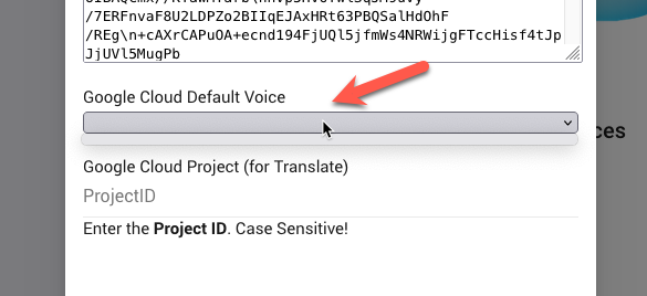

I’m trying to setup the Google service - text-to-speech - I have created a project on Google Cloud and all seems fine here.
But my problem is that I can’t choose anything in Voice selection under configuration. The dropdown is just empty. Can anyone help. I have tried to restart the app but nothing helps.
voice
When you press save, is there a message in the Homey App - timeline?
If so, what does it say?
Thanks… :slight_smile: The timeline message was very usefull - the Text-to-Speech was not enabled under Google Cloud… Thanks for the quick reply… :slight_smile:
