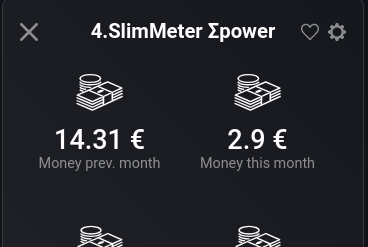

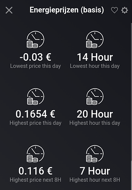

If I may interfere, as far as I know it is a Homey (201x) issue, it is not (well) prepared for currency numbers, and it removes all trailing zeros from values.
(no clue if v10.x firmware finally fixed this issue)
These are currency values from PowerbytheHour for instance.
This device shows currency values with 4 digits, but Homey removes the trailing zeros:
And with regular currency values, the two digits become 1 or zero when the last figures is/are 0:
