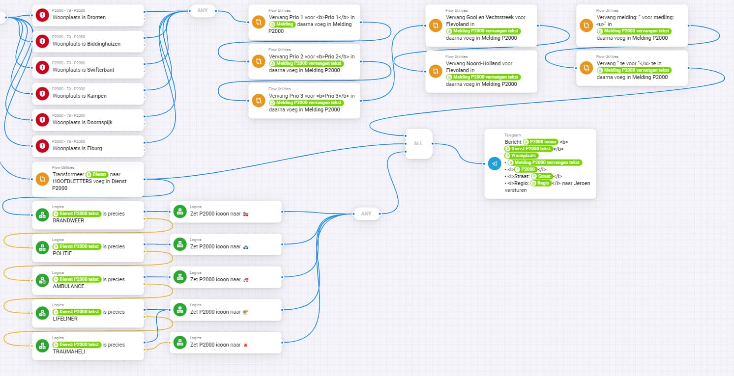

@JMH nice flow you make. Can you share it?
Don’t look how it is organised, but here is my flow:

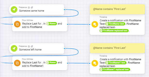

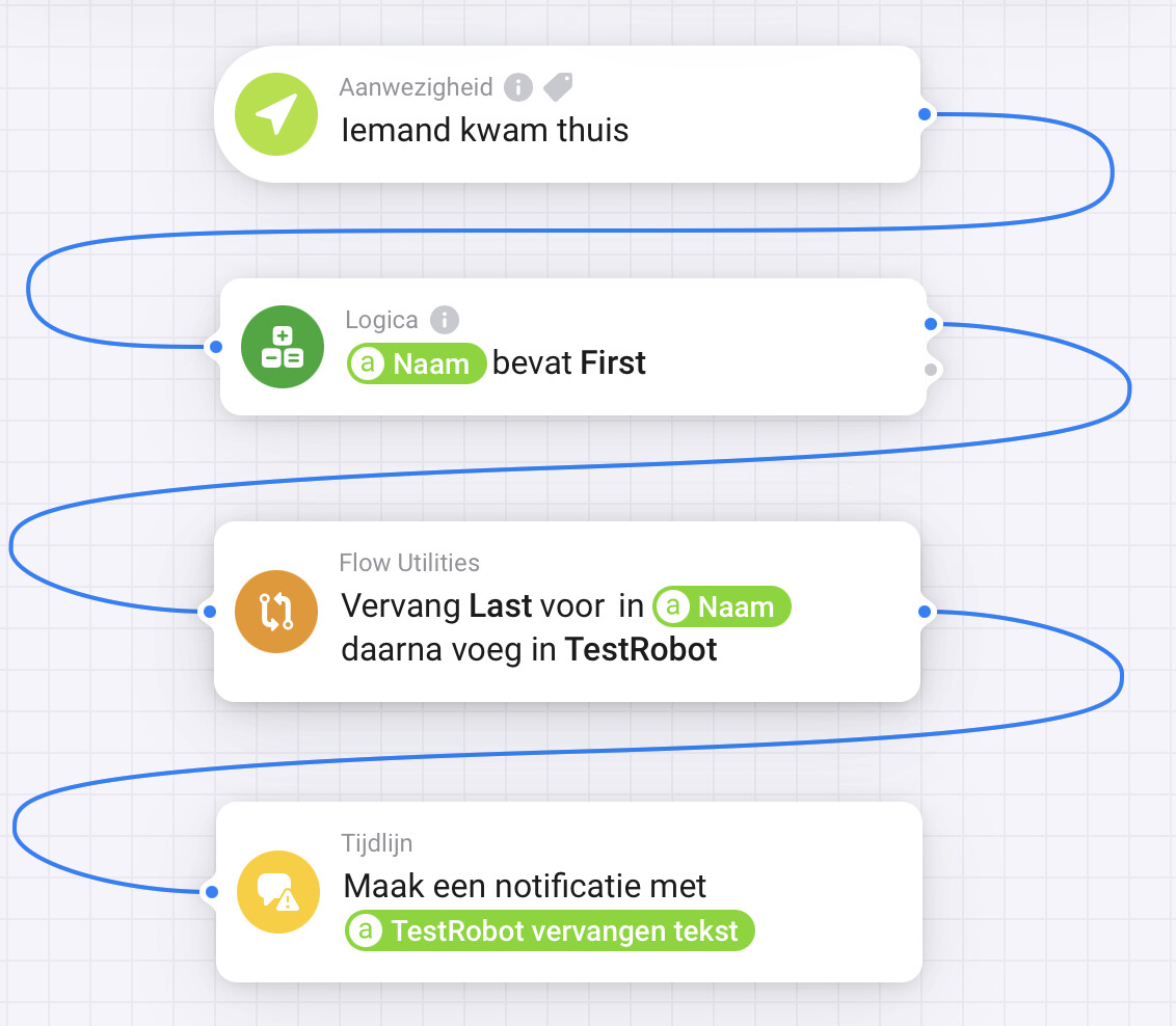

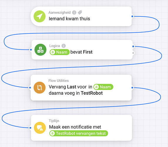

@RobbertV Great app, I have been looking for text replacements for so long!
Please can you help me with this. I want to remove the last name from a name (First Last).
  1. Is there a way to replace it with empty?
  2. The variable @FirstName text seems empty, what is its use?
  3. I had to use a new variable FirstName1 for the second instance, why is that?
@Rrrr
  1. Yes there is, it’s a bit of a hack. But you can put a space in the input field.
  2. This variable is used for the action card to format text to different text formats f.e. Camel case or first letter capital. When this action card is not used yet It will be empty by default.
  3. The way you are using the action cards is not how the app is designed to handle dynamic data. When the action card is used it will overwrite its previous value.
    Seeing your test flow with multiple people in the house this will lead to inconsistent outcome values.
    What is better to do is a logic card in between presence and action card to filter names to its own variable.
