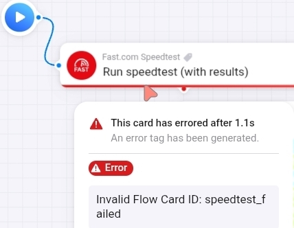

On my Pro 2019s, the action cards are currently still causing an error (Diag 4c8da65e-28c2-48cc-b1f7-e17f323102a8)

@martijnpoppen Shame on me :rofl: , it’s due to AdGuard blocking api.fast.com (but why would it…) I honestly don’t know why Pro 2026 got results anyway.
I got fooled by the error message it self “invalid flow card ID”

Update2
I just discovered fast.com seems to be part of the “Netflix service” according to AdGuard.
So, blocking Netflix service == blocking fast.com as well :face_with_peeking_eye:
I have exactly the same problem… except I’m running only one Homey Pro 2026 with a couple of Pi-Hole servers that are running Unbound recursive DNS as their upstream resolvers.
I too had the evil overlords Netflix blocked. At first I got the same error as you did @Peter_Kawa, so I whitelisted api.fast.com and the test then ran, but with Zero bytes on the Download result. Then I remembered why I had been running manual speed tests with Ookla’s Speedtest for years… ever since I fell out with Netflix and blocked them ha ha, because the servers Fast’s test connect to are Netflix and that’s why I got 0 bytes download. To be honest, I have found Ookla’s Speedtest to provide more consistent results, but I haven’t tried many others for a fair comparison.

@Peter_Kawa @Drako74 yes correct it’s part of Netflix. However this was the only Speedtest which I could run via a API. So you might consider unblocking Netflix? :stuck_out_tongue:

To other AdGuard & non-Netflix users:
What I did to make it work when AdGuard is running on your network:
:cross_mark:My first thought, but this doesn’t work:
  • add a custom rule to explicitly allow this URL: @@||fast.com^
:white_check_mark:What does work:
  • Disable the generic Netflix service block
  • Add these custom rules to block these URLs:
    (thanks @Drako74 )
||netflix.com^
||nflxso.net^
||nflxext.com^
||nflximg.net^
  • Add these custom rules to explicitly allow these URLs:
@@||api.fast.com^$important
@@||nflxvideo.net^$important
(I’ve sent a diag as well, Martijn. api.fast.com is allowed by AdGuard)
