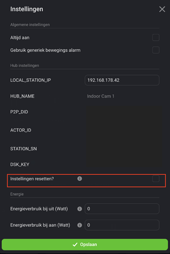

New app update (test: 2.26.2):
Changelog:
1. NEW: refreshSettings option in device settings.
2. FIX: Reduced app size with 1.5 MB :tada:
3. FIX: P2P actor_id not found on Non homebase devices
Note: After the latest update the settings are not in the global settings page anymore. It’s not possible to update device settings. This change adds a checkbox to the device settings tab to refresh the latest settings.
When you check the checkbox and hit save the settings will be refreshed.

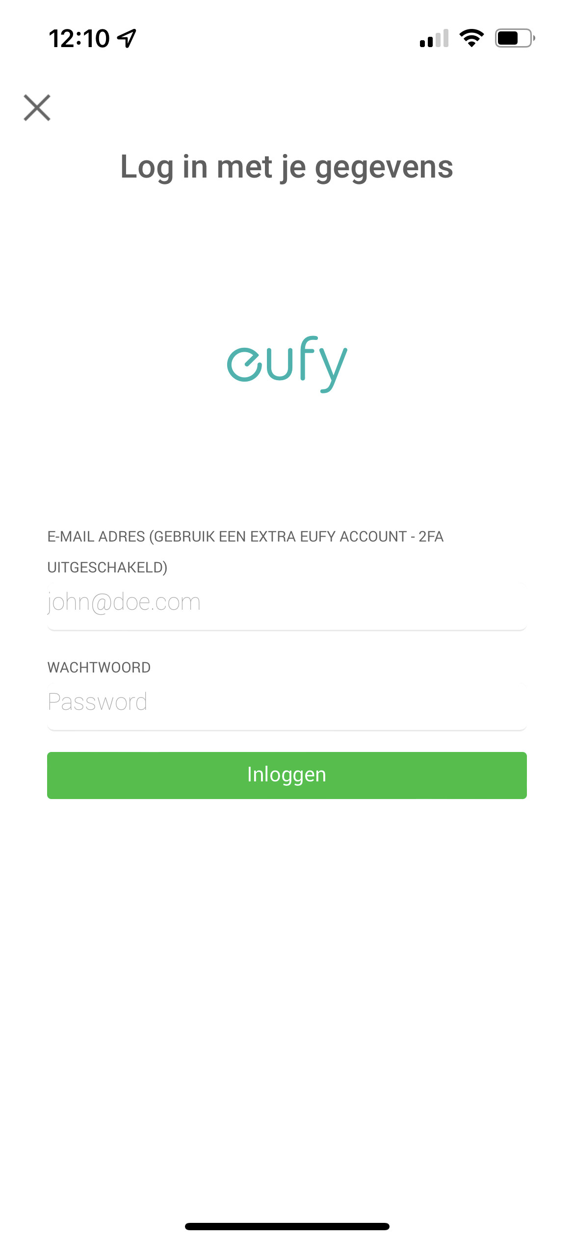

First of all, thank you for creating and supporting these Eufy products.
I’m running into some problems when adding Eufy products. As soon as I log in to the app with a 2nd account, it says “Logged in to EufyLife”. If I then go out of the Eufy settings page and then go back I see the error message “Can’t find variable: initClear” see screenshot.
If I want to add a doorbell, I am asked (again) to log in. If I log in here with my 2nd Eufy account without 2FA, it will load and then return to the login screen where I have to log in my data again.
I have already reinstalled the app once. I am also now running the latest experimental version of the app (version 2.26.2). Anyone know what’s going wrong here? Diagnostic report: 023da891-afa3-480e-964d-602d42651bf9
Thank you in advance
