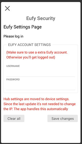

1. NEW: Eufy Cloud IP discovery.
2. NEW: Make all Hub settings part of device. (Removed from settings page) (see image below)
3. NEW: Retry mechanism if P2P connection failed. 3 tries before fails. (Local IP, Eufy local IP, Eufy Cloud IP)
4. FIX: Improved login system in pairing.
5. NEW: Warning if user didn’t setup a Homebase. (Homebase is required because settings are not global anymore)
6. FIX: error logs
7. FIX: standalone cam without P2P connection showed a error
Images for item 2
