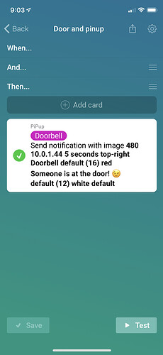

Allright… Restarted Homey, but still encounter issues.
Test Pipup:
Turns out that if you use the default image, the image can be used. But as soon as the notification image needs to be used, nothing happens…
Any chance it could be a resolution or file extension issue?

I always use the image tag, just like I do for Pipup
