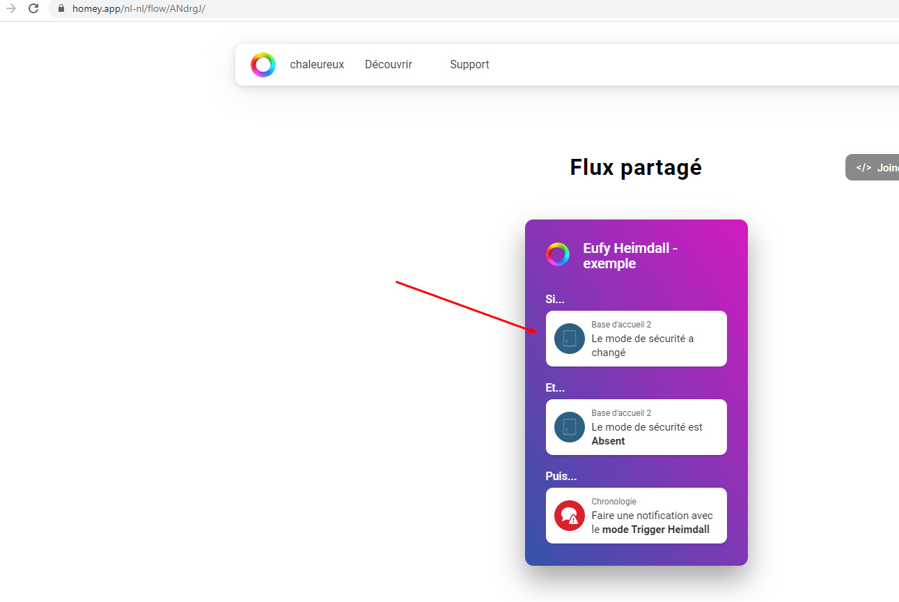

nb1 :
It seems i am missing this card on my Eufy Indoor Cam
That card is about if eufy mode has changed
Nb2: i dont have homebase just eufy app
Hey @mattrix ,
Just read your message. Geofencing with a stand alone camera is not going the work.
Only the Homebase reports it’s security mode.
Once I get 2FA working it should be possible as user don’t get locked out anymore.
I’m working on that part and hopefully i can push that in the coming month.
After that i’ll make fixes for 2-way communication.
