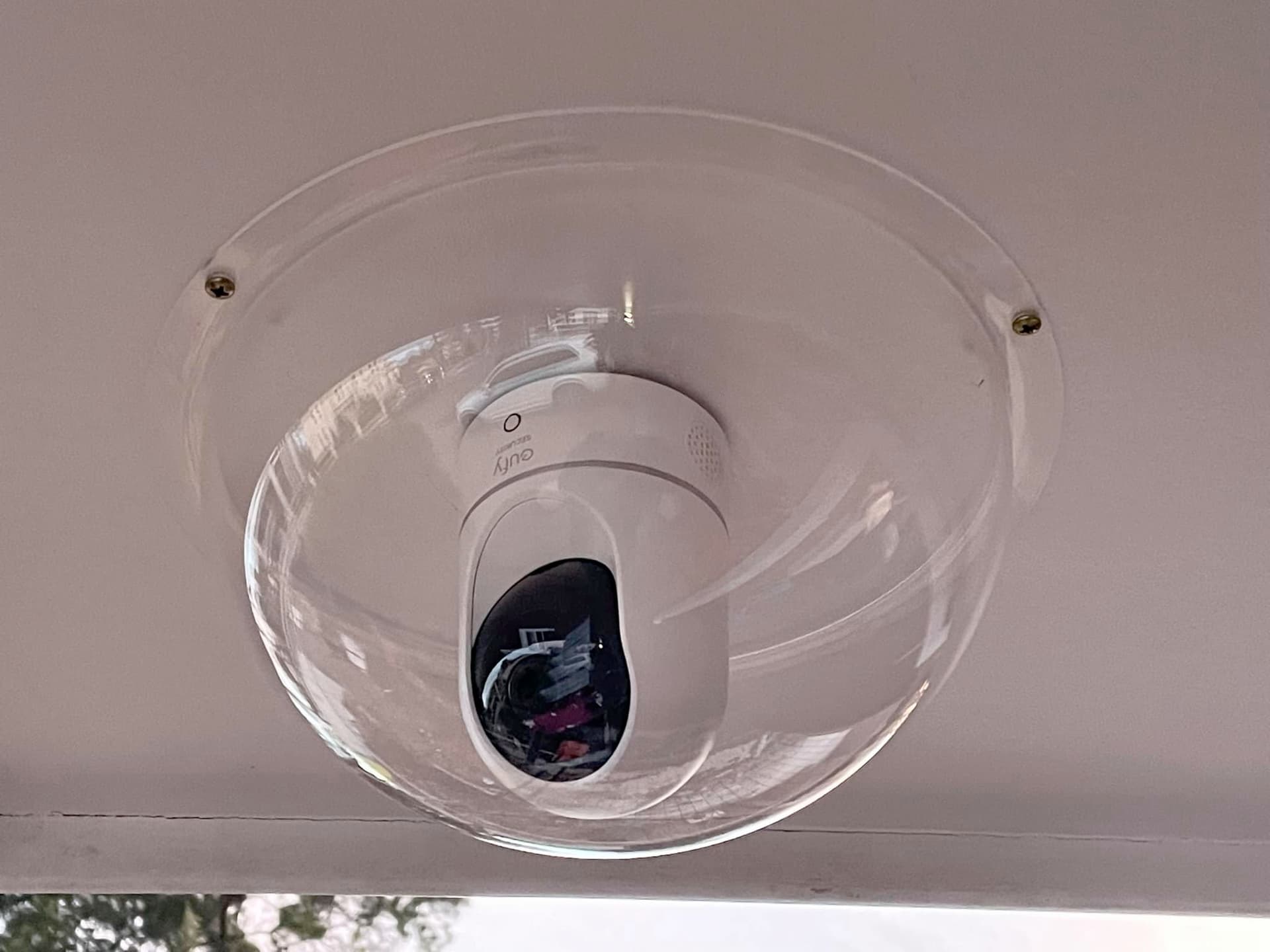

I think if you put the PIR in something like this it will be possible? :stuck_out_tongue:

The PIR “protection” structure seems like a good alternative :smiley:
