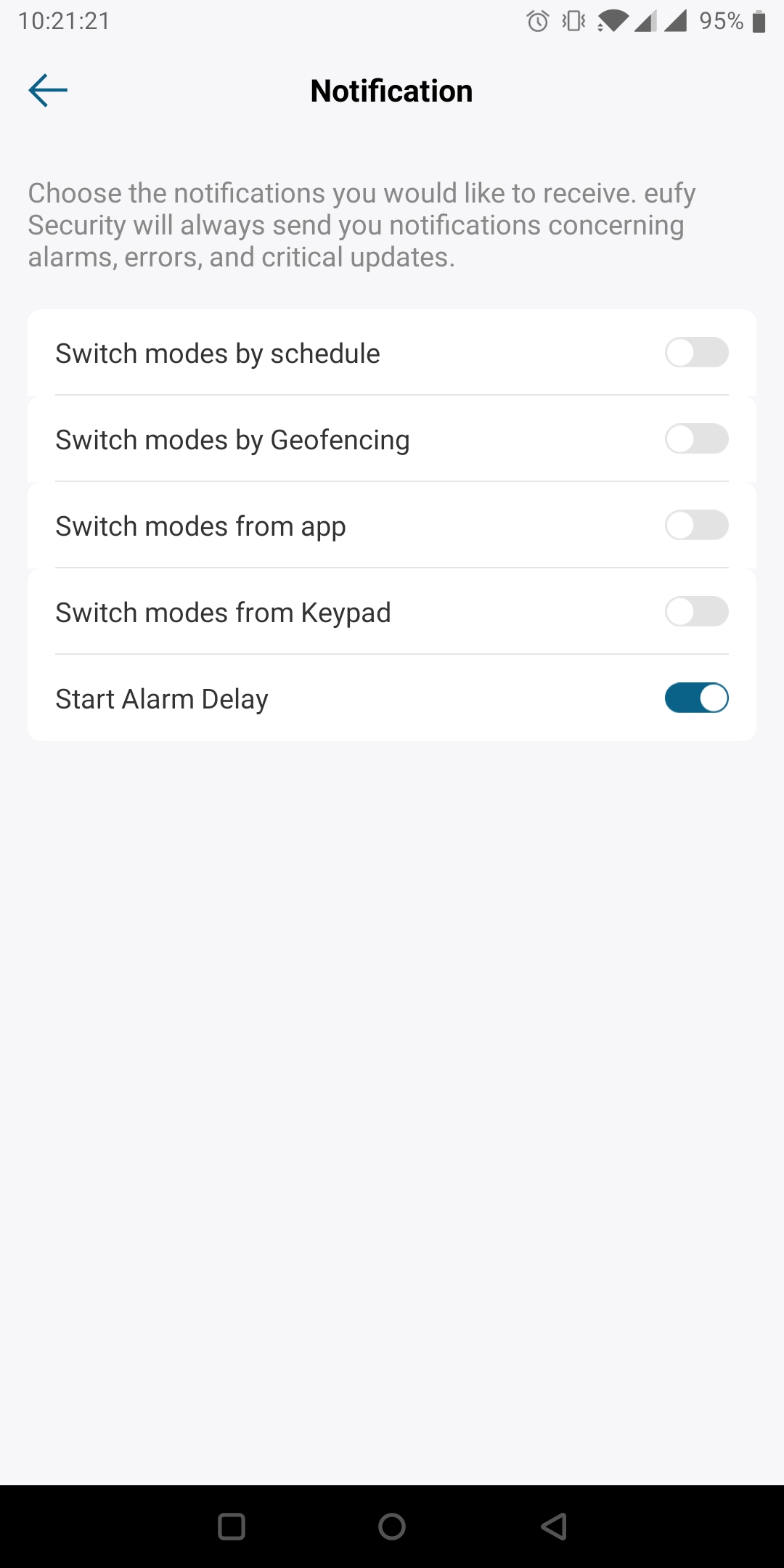

This morning I noticed an issue with setting the alarm to home.
Because I had changed some things in my go to bed flow the alarm didn’t go to custom 1 (sleep mode) so I had to do it manually on the keypad.
This morning when I woke up my wake up flow started but couldn’t set it back to home mode because it didn’t recognize that it was on custom 1.
So I tested it and indeed, when set manually a mode on the keypad flows that wants to change the security mode won’t work.
Is there a way to fix this?
Thanks.
@Heula
Eufy has an issue where te notifications from the homebase are turned off. Can you check that? I have this issue too. In the new version of the Homey app (with the new library) I can force these settings. Left is how I see it everytime. Right what it should be
That is odd, I had the settings set as in image on the right but when I just looked now it was set as the image on the left. When setting it back to the right image the flows works just fine. I will check if this keeps changing without my doing.
Thanks.
Yeah exactly. So that’s what I said. That’s an Eufy issue. It somehow resets. Hopefully we can fix it in the new version :crossed_fingers:
