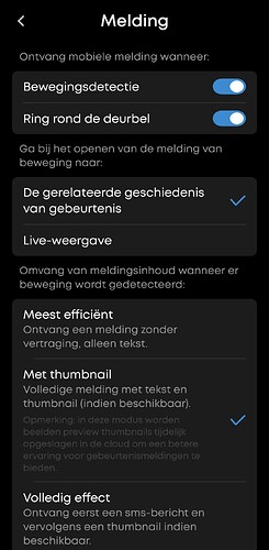

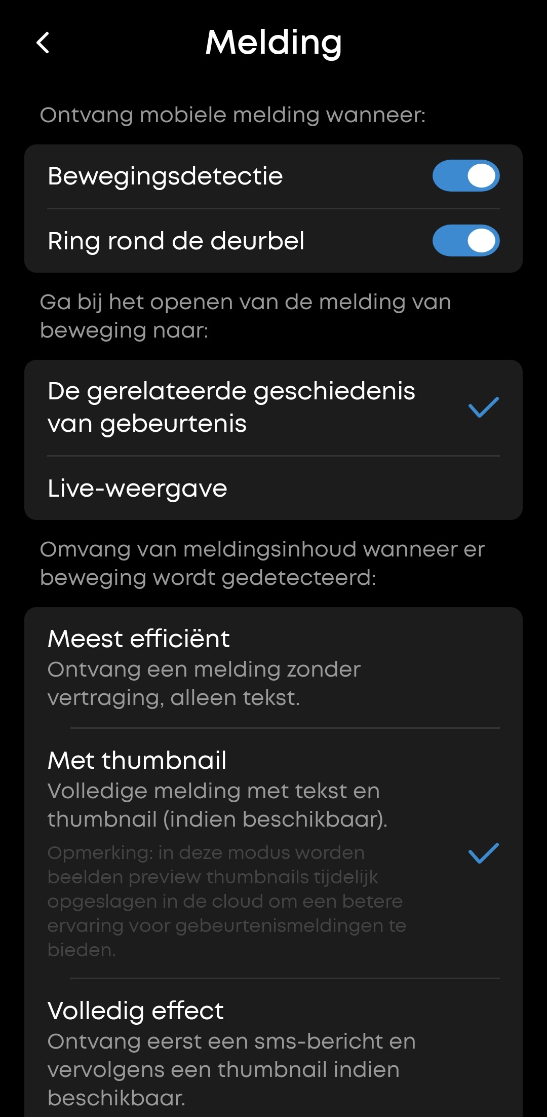

Hi @martijnpoppen, Thanks for your work on the app!
Just a quick question. Snapshots don’t seem to work for me. I’ve set all the settings in the Eufy App correct, also I’ve made a flow that takes a snapshot when the flow is started and a snapshot that takes a snapshot every time the area get’s active. But then still, when I make a flow that triggers a notification I get a notification with an old snapshot. If I start a flow a couple of times that should make the snapshot it still doesn’t make a new snapshot. Do you maybe know what I am doing wrong?

@Avi_de_Winter can you try with some delay in between or use it in advanced flows

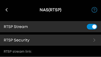

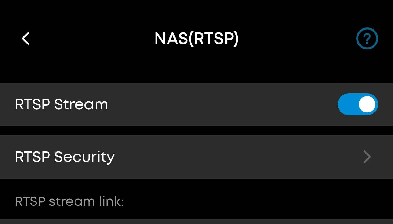

FYI all, made interesting experience. For some reason, on EufyCAM 3 with HBS 380, I have to keep RTSP enabled to get local snapshot working.
So this is the setting which works for me just fine :
Anyone having same experience ?

I did a test here and with RTSP enabled, snapshot works again… I guess that will impact the battery life? I have disabled it for now again.
