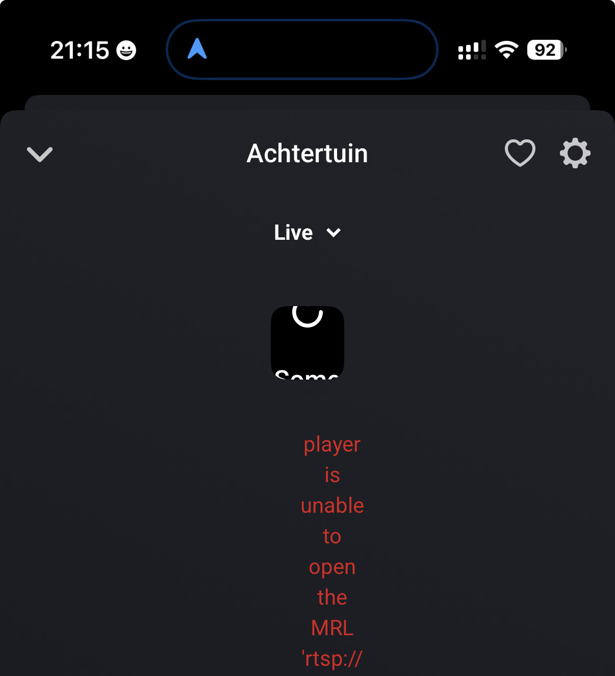

@SmartChef are the homey and the camera in the same network? is your phone on the same network as your camera?
Edit: Al gefixt…
Yes they are. Can it be a firewall thing?
@SmartChef yes could be
If I’m correct is should show the stream MRL ?
@SmartChef i do see the MRL starts with rtsp, so that should be correct, if you copy that url and try to see it in VLC on a laptop does that work?

Hi Martijn, nope. Also doesn’t work. Tried it on my laptop on the same network. I get a can’t connect and can’t open error message in VLC.
I use the link that is generated by Eufy.
Still guessing what could be the problem. What I found online is: When VLC can’t open an RTSP stream, it’s usually a network issue, firewall blocking, wrong URL/credentials, or a specific VLC ; try checking firewalls, adjusting VLC’s Demuxer settings (RTP/RTSP TCP), ensuring the URL is correct (escaping special characters), and restarting devices.
Any ideas?

@SmartChef no no idea
But if it doesn’t work in VLC it won’t in homey
You can try to set a different encryption mode in the NAS settings of the camera, basic or digest
Hi Martijn, I think I found the reason why it’s not working.
Eufy support says: The Floodlight Cam E340 does support RTSP/NAS when it operates independently. However, if it is connected to HomeBase 3, the RTSP/NAS function will not work at the moment. The RTSP feature on the camera is compatible with NAS devices that support the RTSP protocol, and Synology NAS is confirmed to be compatible with eufy Security. For other NAS brands, compatibility has not been tested by eufy.
In my case I have the camera connected to a Homebase 3 so now I know why it’s not working. Thought I might share this for others that have the same set-up. Took me some time to figure this out.
