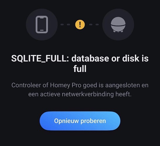

Since last eufy app update:
Removed Eufy app now everything back to normal.
Please can you fix this Homey pro 2019
Best regards Adri
@Adri1 Without a diagnostic report I’ll be unable to help you. Please provide that
Next to that, this is not a Eufy Security error but your Homey saying that a database is full. I would recommend to restart your Homey as that will clear up the memory.
SQLITE_FULL most of the time means your Homeys memory or data is full. Restarting would be the first best action
Hey Martijn,
I reset twice the homey and after about 20 hrs again same msg.
Someone else has the same problem and found out that the Eufy app was updated.
Removed Eufy app and till now it works okay.
I send you tomorrow a report( is this possble because your app is not at my device?)
Best regards Adri
@Adri1 No you can’t send a report if you don’t have the app installed.
But i would encourage you to contact Homey support. This is out of my hands I can’t influence the Homey Database

Hey Martijn,
No more problems with Homey — today I reinstalled the Eufy app.
HomeBase 2 and two EufyCam 2 Pro cameras worked without any issues.
But when I added the battery doorbell 1080/2K as the last device, Homey immediately crashed with the same error.
I reset Homey, removed everything related to Eufy, and reset Homey again just to be sure.
Installed the Eufy app, and the two cameras worked fine again.
I think something goes wrong with the doorbell after the latest update of the Eufy app.
