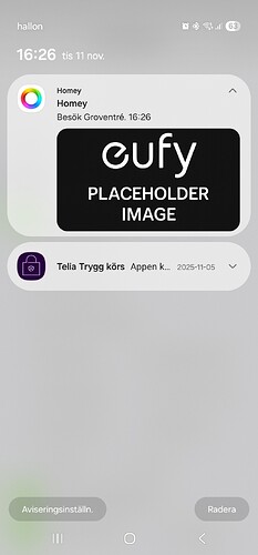

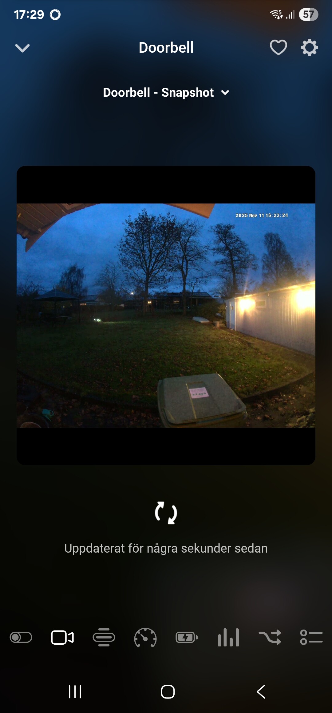

My event images have stopped working, I get “Eufy Placeholder Image”. I added RTSP and now I can get a picture in the Homey app, when I pick Snapshot but not Event.
@ExtraKim still those are 3 separate things. You don’t need RTSP for a snapshot or a event image

But I changed the mechanics of images as I was changing the snapshots to be local I had to update the image logic. So event images have been changed how they are saved, might be that something went wrong there. But I need a report to investigate that
Still no relation between the 3
Something have changed since I have used push with a picture for two years and now I just get this.
I will just activate a push and then send you a report.
