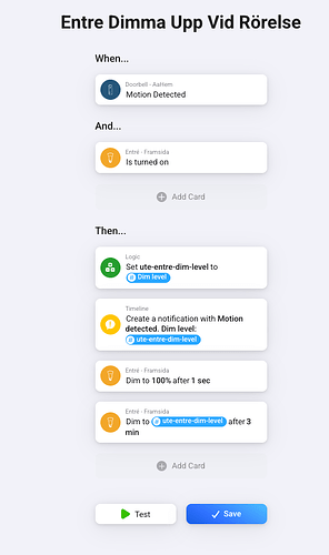

I havent been a very active user of the app, but now that its getting darker, I was missing the result of this flow on my driveway. Basically, I want Eufy to trigger lamp dimming up when motion detected.
But this flow has for some reason been broken for a while. And now that I look into it, it seems the Doorbell hasnt sent a Motion detected for the last 2 years, while it keeps sending the “Person detected”. But since I want to trigger this also when a car drives into the driveway, is there any way of getting the motion to work? I tried a bunch of things in the Eufy mobile app, but no luck.

@Jari_Peuhkurinen check FAQ Q1 [APP][Pro] Eufy Security - #4 by martijnpoppen - Apps - Homey Community Forum
And indeed it’s slow due to the way this app works. Nothing I can do about that
@Sigurdur_Birgisson go to the motion settings of the camera in the mobile eufy app and enable other motions
This is how my screen looks in the app. I don’t have the same as you. This is a dual video doorbell
@Sigurdur_Birgisson you did enable ‘all motion’ so that’s correct
Also check FAQ Q1 for correct settings [APP][Pro] Eufy Security - #4 by martijnpoppen - Apps - Homey Community Forum
