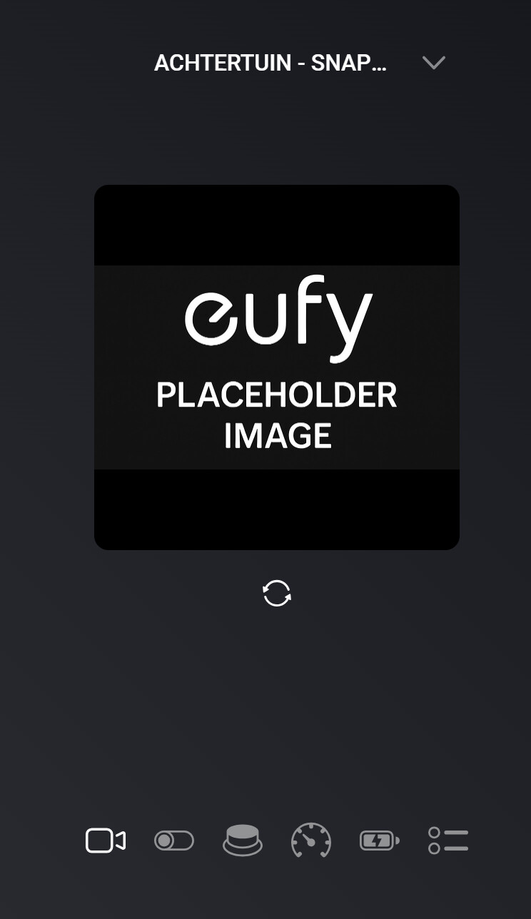

Using the live version gives me this image as snapshot:
7d55d016-1e6a-442a-a4e3-4da256a54cf2

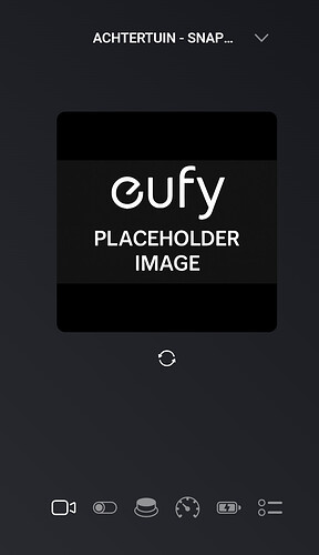

Hey @martijnpoppen,
First of all — thanks for the awesome Eufy app! :clap: It usually works great, but right now my backyard camera seems to have gone a bit… shy.
Instead of a live feed, I’m getting this stylish ā€œEufy Placeholder Imageā€ — very modern art, but not exactly what I was hoping to see. :sweat_smile:
Any idea what’s going on here?
Is my camera taking a break, or did I mess up a setting somewhere?
Thanks again for your great work and all the time you put into these integrations — they really make Homey even better! :raising_hands:

Hi, I can see why they were removed in the first place, but like some others said in the meanwhile, they don’t seem to update after events either.
@Glenn_Dijkstra can you send a report?
@Willie_Plompen do you have a flow to set the snapshot?

@r.7255 the live expect that you enable snapshots in the device settings . That is removed in the test version. Can you do that first and try again?
@Glenn_Dijkstra i think I know what goes wrong
Will check
yes
@Willie_Plompen then it seems the same issues as the others reported at the same time with you
Will check it out
