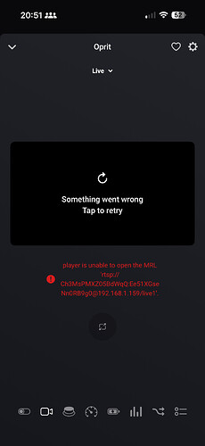

@martijnpoppen **Unfortunately, it’s going wrong again
:smiling_face_with_tear:
@Linden85 i cant do anything about that
The url looks correct. If you check the eufy app you probably see the same url.
This looks like a networking issue between your homey and your camera. I can’t help with that
Only thing homey does is consume the url from Eufy. The eufy homey app doesn’t do anything with it
@martijnpoppen
If what you’re saying is true, then why is the live feed restored when I restart the Eufy app?!:nerd_face: And why does it go wrong again after a while?
Homey is connected true a ethernet connection and i have zero connection issues with the Eufy application and with other hardware🧐
I have the same problem. It works for a while and then it stopps

@Linden85 @Lukasz_Kostek
As I mentioned the homey app doesn’t do anything with the url other than returning it
But please send a report when it stopped
I assume you already tried to restart the stream? From the dashboard for example? (You can click the stop button )
Also please validate if the url is the same as in the eufy app. That’s not something I can check. There shouldn’t be a change
I’m combining the message to you both as you are facing the same issue.
I did ask Athom for help on this issue to see if they know anything about the stream timing out
Next to that i’m also running a stream to see if it stops at some point.
Please also check my previous message, maybe we find something which explains this behaviour
@martijnpoppen
-trying pushing the button doesn’t work unfortunately.
  • url in the eufy app looks the same
@Linden85 thanks. do you have a idea after how long the stream stops?
