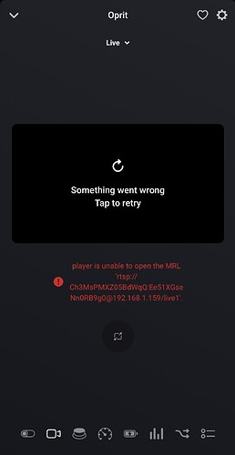

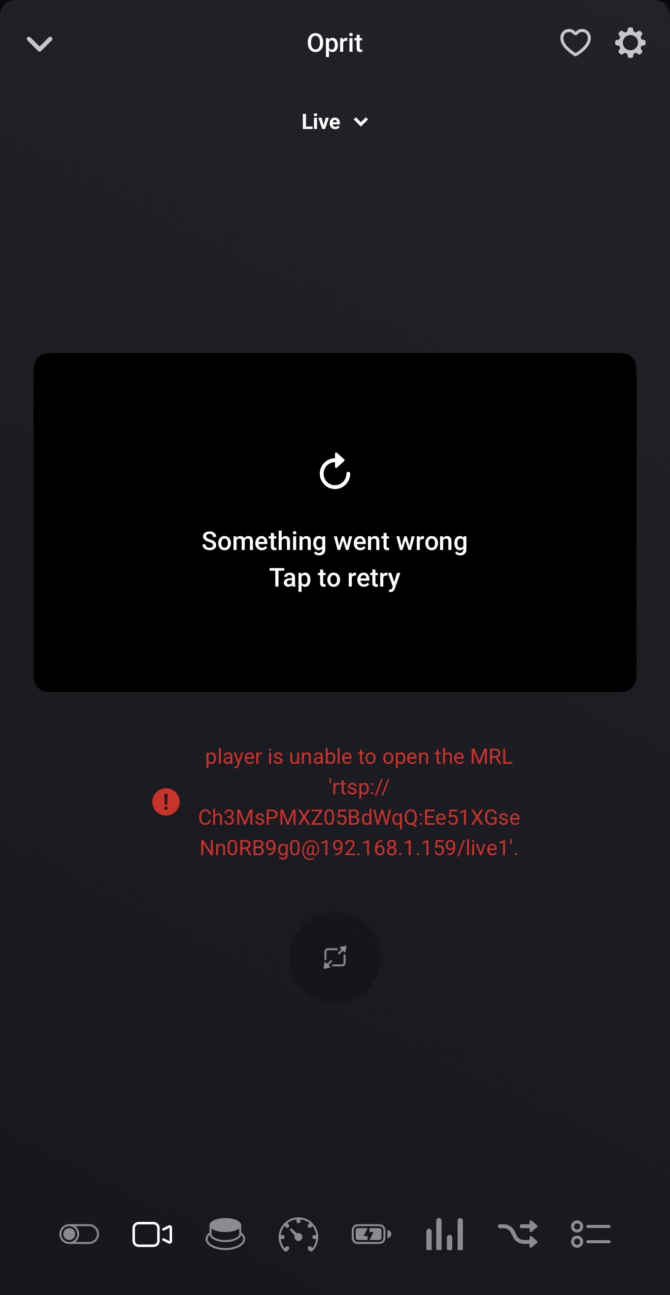

I have two C220 cameras. One works perfectly and live streaming functions as expected. The other one doesn’t stream live. The only difference I’ve noticed in the RTSP setup is the address: username:password@192.168.1.40:554/live0 — and this one includes port 554 in the setup name, while the other is missing it. I’ve tested both streams using VLC player, and they work there.

i do see that Carport is not responding to RTSP. I think this is the device you expect?

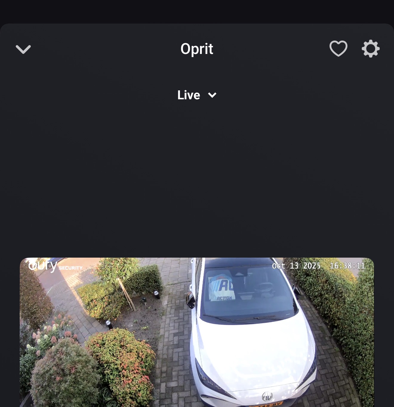

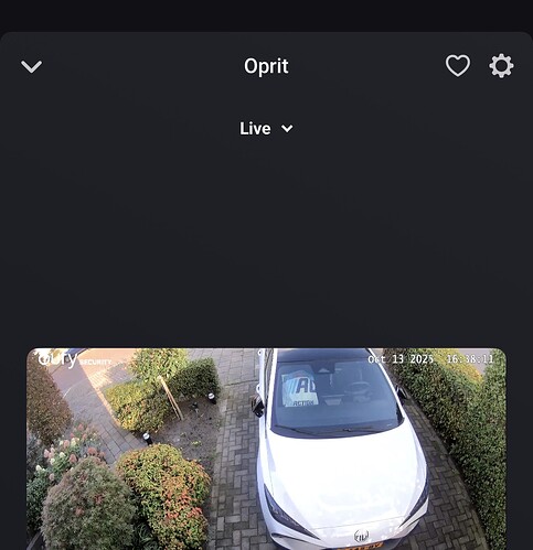

After a restart of the Eufy app the live feed work but after a wile i see a url error .

@martijnpoppen after a restart of the app i see live feed of the camera but after a little wile i see :slight_smile:

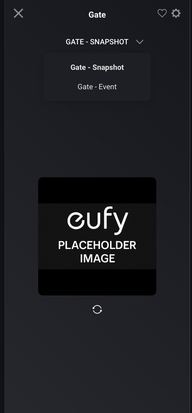

I don’t have error. I can’t choose Live on my camera. In options there is an info that RTSP stream is not supported and to turn it on on EUFY app what I did
@Linden85 are you on your local network? or is this via 4g/5g?
@Lukasz_Kostek Where do you see that?
Edit: i see what you mean, that setting is incorrect, leftover from development, so ignore that

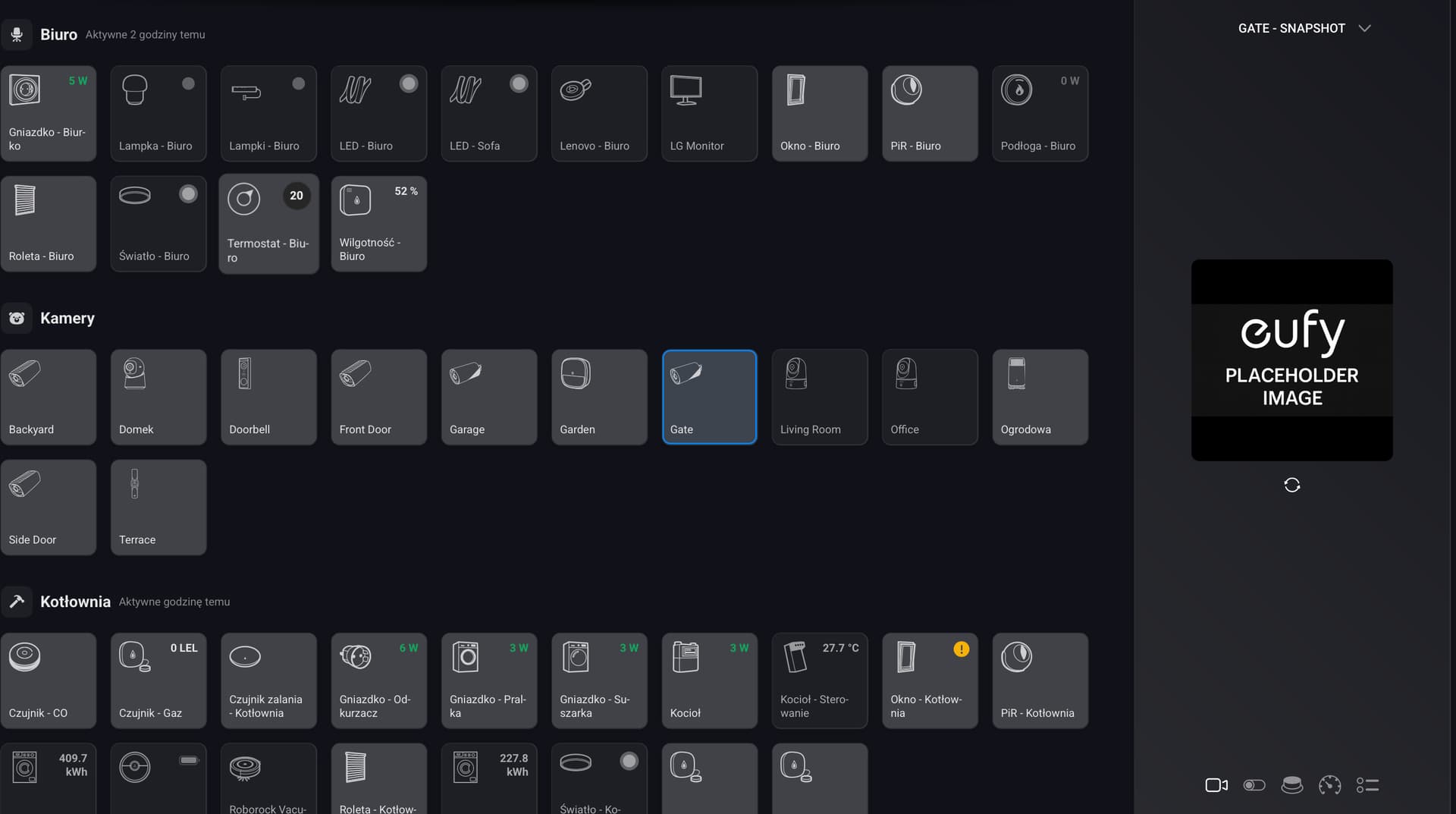

I don’t have LIVE option to choose from menu
@Lukasz_Kostek is that the homey webapp?
