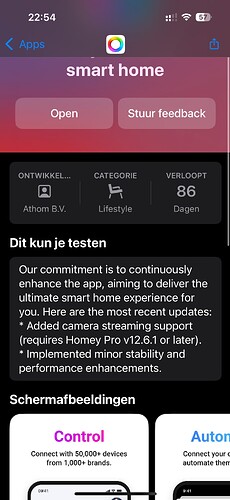

@martijnpoppen now the newest update supports camera streams will you have a look at it?
@Sibren_ter_Hove this is a English topic
Please edit and translate your post
also not aware that the stream are released yet, can you share the link to that maybe?
What link do you want me to send. They only showed it in the new app version. See the screenshot
@Sibren_ter_Hove ah you’re running the beta. It’s not official released yet
But I’m already working on it for a while, but unfortunately it’s really memory intensive and crashing out the app. Maybe i get it to work, but don’t think so
Homey has to parse the stream as well, as the webrtc of eufy is completely encrypted and i can’t get that decrypted at all
