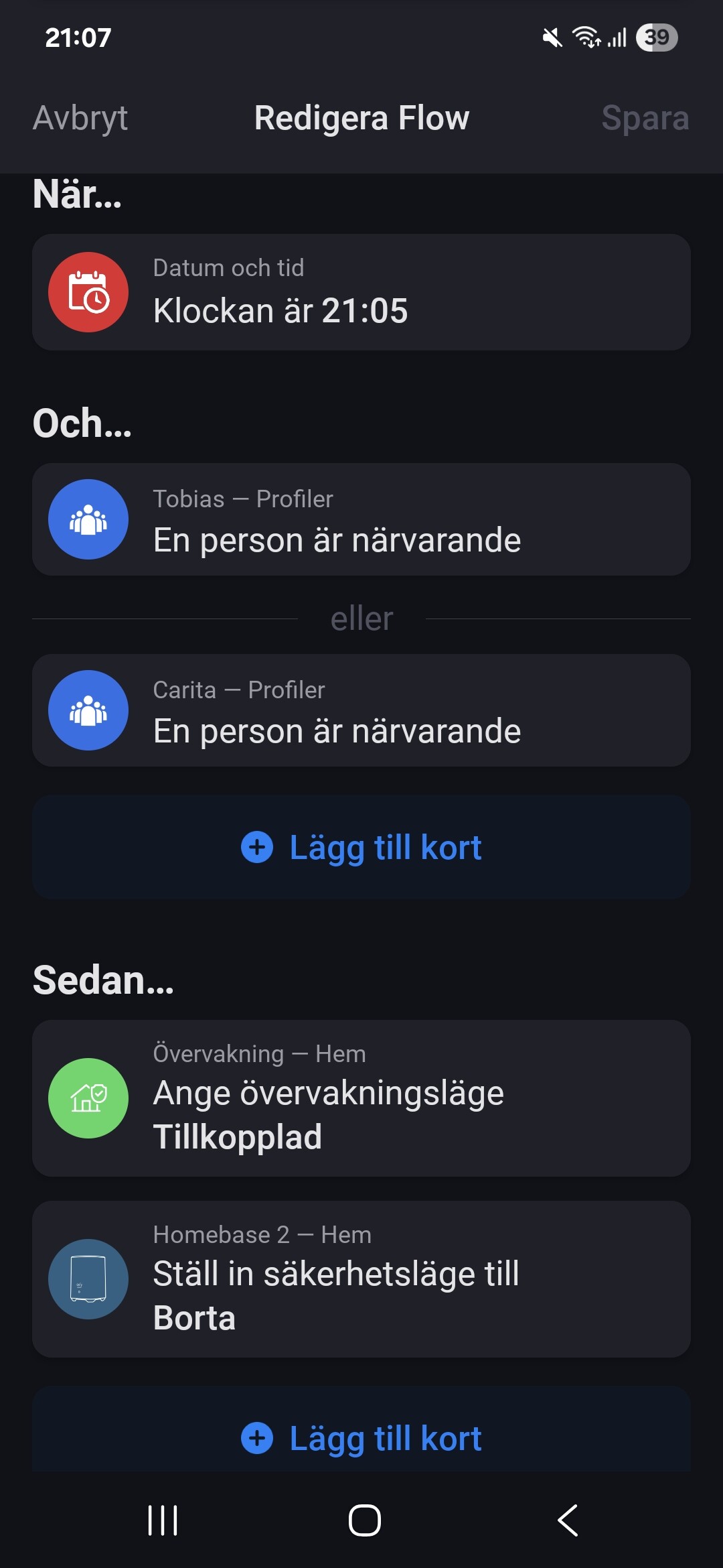

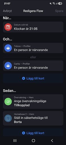

Don’t exactly know what I did but it seem to work now.
Removed and added homebase yesterday and today I took the poweadapter out from Homey for an hour or so.
Then I created this flow and then homebase changed security status automaticly.
