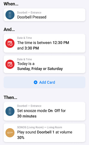

Hi @martijnpoppen, many thanks for your response. So, do you think the flow below should do the trick, snoozing (muting) the doorbell chime between certain times and playing it on Sonos instead?
@Baguette64 yes that should do it. if that’s not the case then please send a diagnostic report
