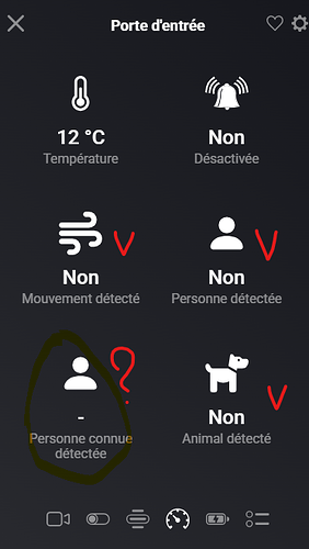

FAQ Q16 :wink: Sorry, maybe translation Google is wrong :smiley: Homey knows when it’s a personne but not if this personne is me. The Flow with “the personn is” doesn’t work. Maybe with a picture, sorry it’s in french

@Gerald_Delhaisse then the person is not coming trough. Person detected is also No i see, so there’s no detection
When there’s a known person also person detected should be Yes
and I did mean FAQ Q1 as it doesnt seem you get updates in to homey. Might be related to:
I get update on to homey. I just try now, updating is ok for personn detect but not for known person. Strange. In Eufy, i’m recognise on the record

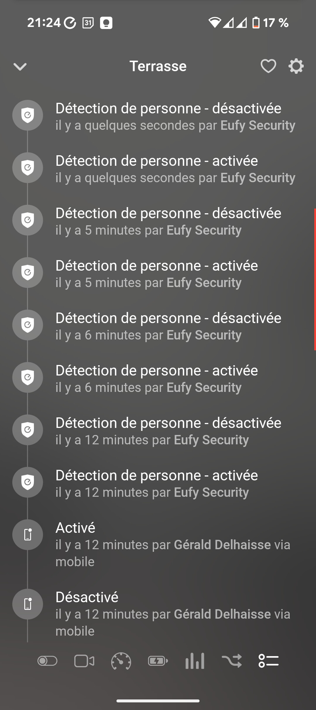

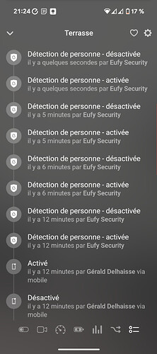

I try to do again the diagnosis when I am spotted but now nothing happens. What I don’t understand is the difference between the 2 screens. In 1 every movement is repeated, in the other no detection.
@Gerald_Delhaisse screenshots do not really help to debug the issue
Please send a report when possible
