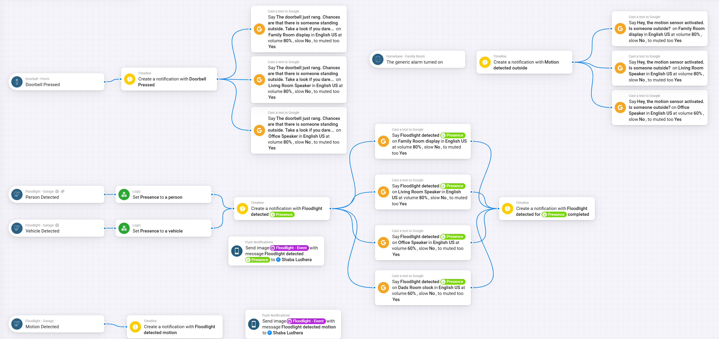

Since the firmware update, I no longer get any activity alerts that have been set up. Non of the below flows are now firing but were working just before the firmware update. I have restarted Homey several times since too..
@Shaba49 not related to the firmware update
Known issue for the eufy app
Unfortunately no fix yet

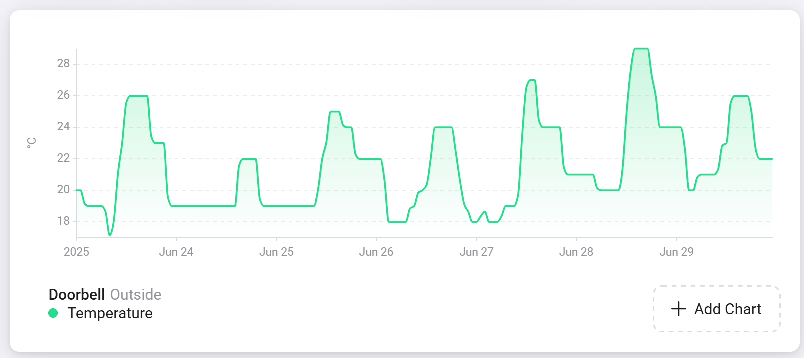

Since 29th June, I’m no longer seeing updates to battery level and outside temperature in either the Homey web app or the Android version. My S330 is wired, but I found the battery level to be a useful check everything was working OK.
I found the external temperature sensor to be useful as it’s the only one I have outside the house.
This is what I’m seeing from the temperature sensor:
Note it has not sent any changes since 29th June.

@Andy_Henderson see FAQ Q5 [APP][Pro] Eufy Security - #4 by martijnpoppen - Apps - Homey Community Forum
Most of the time a issue with eufy servers
Nothing I can do to fix it
That figures as nothing else has changed. Thanks for quick response.

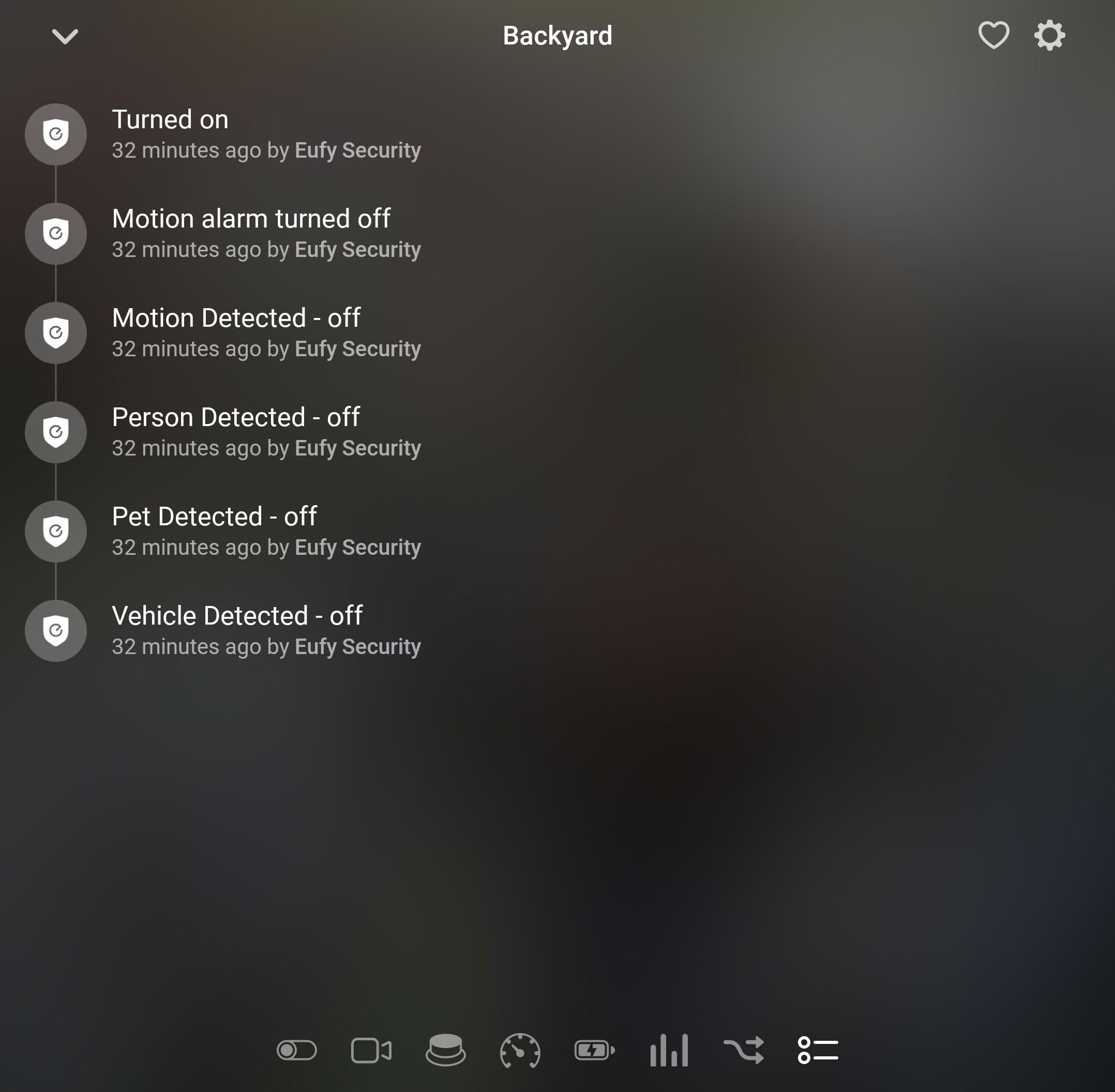

What’s happening to me is that I can add the devices, I can set up flows and they seem to work for a short period and then it stops
When I access the devices, they don’t show as disconnected, there is no warning triangle next to them or anything but the image I see is from just after I added the device.
For example, say I look at the timeline after adding the camera and ive been in front of it, I can see it registers as a person was detected. If I stand in front of it later, there is nothing. The last activity showing is back from just after I added it. I’ve tried leaving it a few days and nothing changes so it’s not a temporary disconnect.
I’ve tried re adding them twice and reinstalled the app and it’s the same behaviour
This shows what I mean, I have readded them today and there is someone in my yard now but Homey doesn’t register it. All notifications etc are working fine within the Eufy app.
