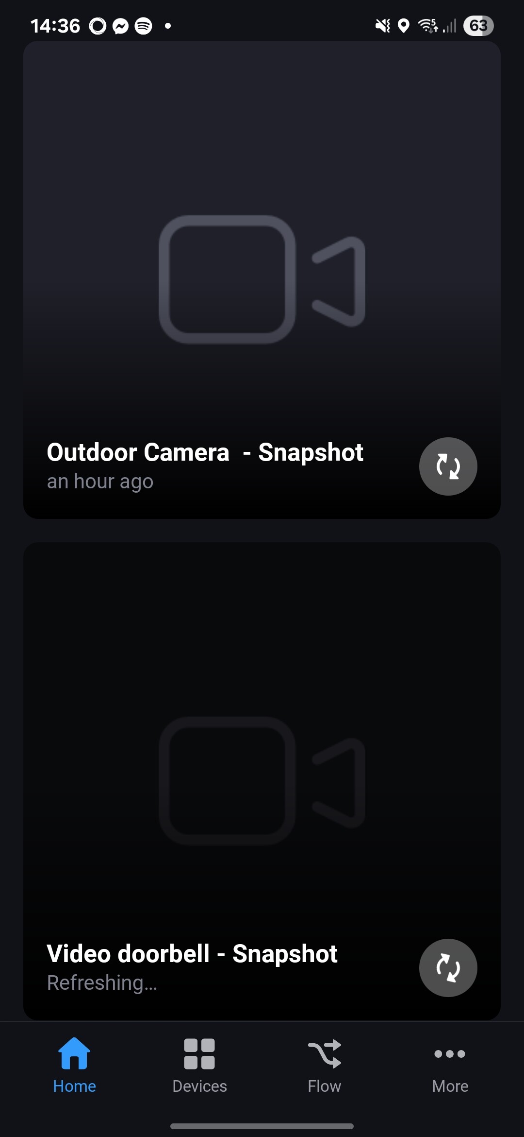

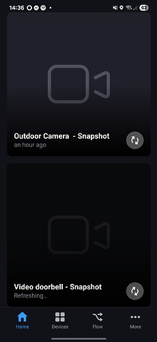

I put widget on my dashboard as a snapshot from cameras. Homey updates snapshot aprox. Every 1 hour.
Issue is that snapshot is not visible most of time. See picture. Any help or recommendstions? Thank you really much.
@Jan_Vitasek please send a report
5b227b05-4db0-4cd7-b7b8-a85c8e624812
@Jan_Vitasek you are snapshots at the same time
Every time homey has to open a stream to a camera it closes the others
Make sure to do it asynchronous
