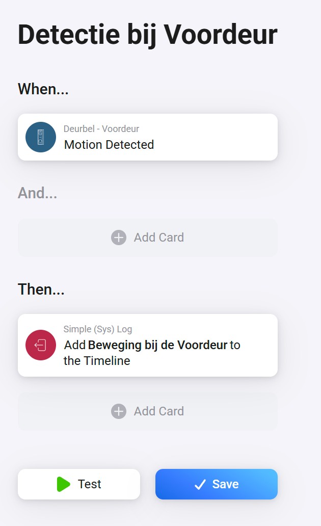

New to the Homey and trying to create some simple flows. However, can get a flow to work which only should put a comment on the timeline if motion is detected at the front door. Can someone help me out? Thanks in advance!
@dude991815 check FAQ Q1 [APP][Pro] Eufy Security - #4 by martijnpoppen - Apps - Homey Community Forum
That’s true! Don’t know why. My bad.
But it still doesn’t work with homebase flowcard only in the webapp and in a normal flow.

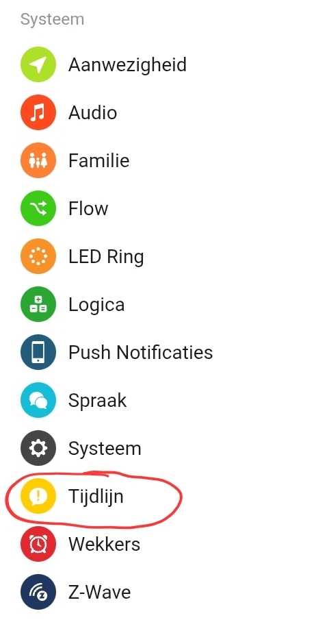

@dude991815 The “Then” card is not the standard card for the timeline notifications.
But if it can’t be THEN, what should it be? I can’t move this card to AND…
Regardless, I get the impression this flow only works if you have a Homebase. Could that be the issue?
@dude991815 did you read my answer?
Next to that you use motion detected while a doorbell recognises 9/10 persons instead of motion
Yes, I did, and as far as I can tell, more or less all questions are considering the use of a Homebase which I do not own.
@dude991815 it’s generic. The settings described in Q1 are also existing for a stand alone camera
Thanks for the clarification! It now works.
