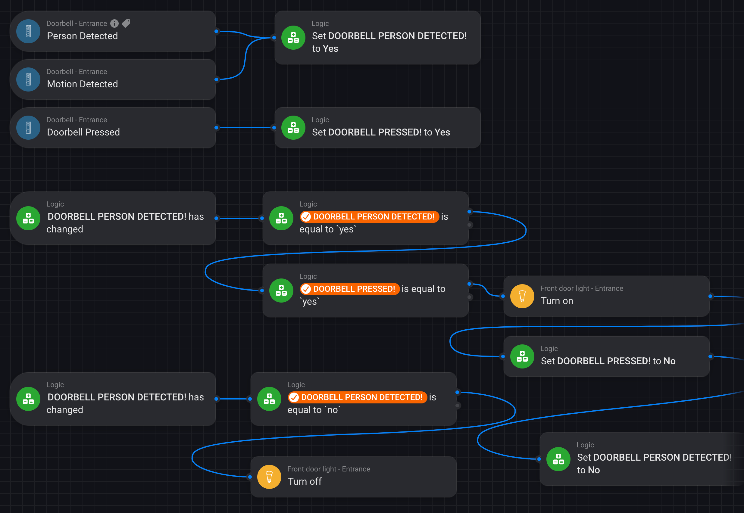

Hello guys…Im trying to create a flow with doorbell E340. When someone press the button , the front door light will be open.
but the 3 cards “Person Detected” - “Motion Detected” - “Doorbell Pressed” dont change the value if Im in front of my door or/and I press the button of the doorbell.
Anyone have the same issue?
@iGiorgis see FAQ Q1 [APP][Pro] Eufy Security - #4 by martijnpoppen - Apps - Homey Community Forum
I saw it. Of course I receive notifications from Eufy app about motion/person detected and Doorbell pressed.
@iGiorgis please restart the app and send a diagnostic report
