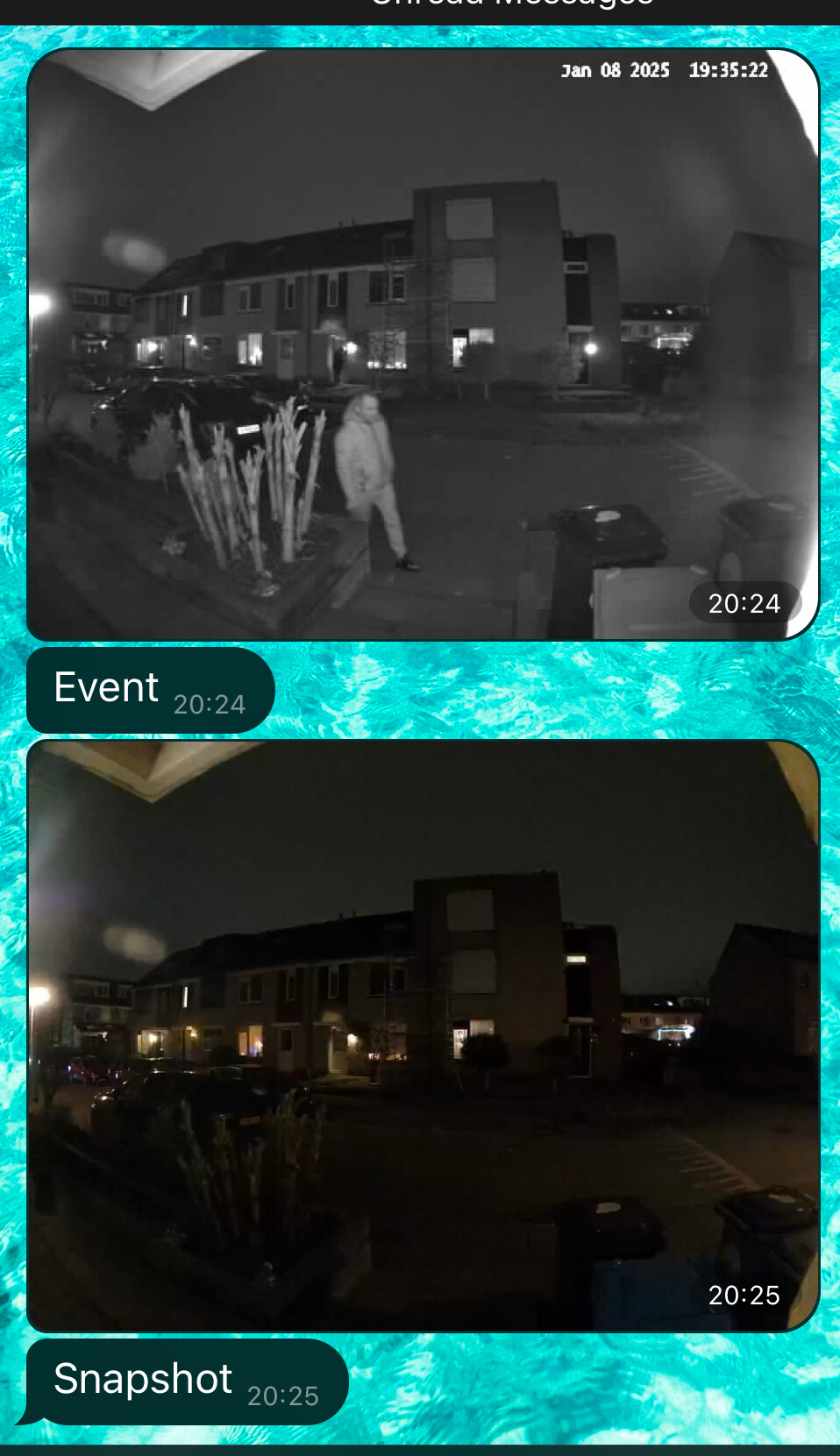

The snapshot. It is not up to date

Ow sorry. We’ve discussed this before, but saw your reply just now :wink: when i use a flow to send the snapshot with telegram after a doorbell press, the snapshot picture is from the day before. I also send the event at the same time, and that one is up to date
@Lennart_Peereboom Can you share your flow in a screenshot?
I’m using it in a advanced flow, so i tried the picture from the webversion. I hope it’ll be oke
@Lennart_Peereboom Which doorbell do you have and is it connected to a Homebase?
I have S220 2K doorbell. And yes it is connected to a Homebase

@Lennart_Peereboom can you retry the snapshot?
I’ve tried it and it looks like the snapshot is up to date now, but the event is earlier :face_with_spiral_eyes:
@Lennart_Peereboom snapshot takes time to take
