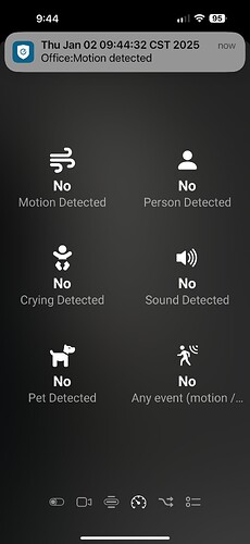

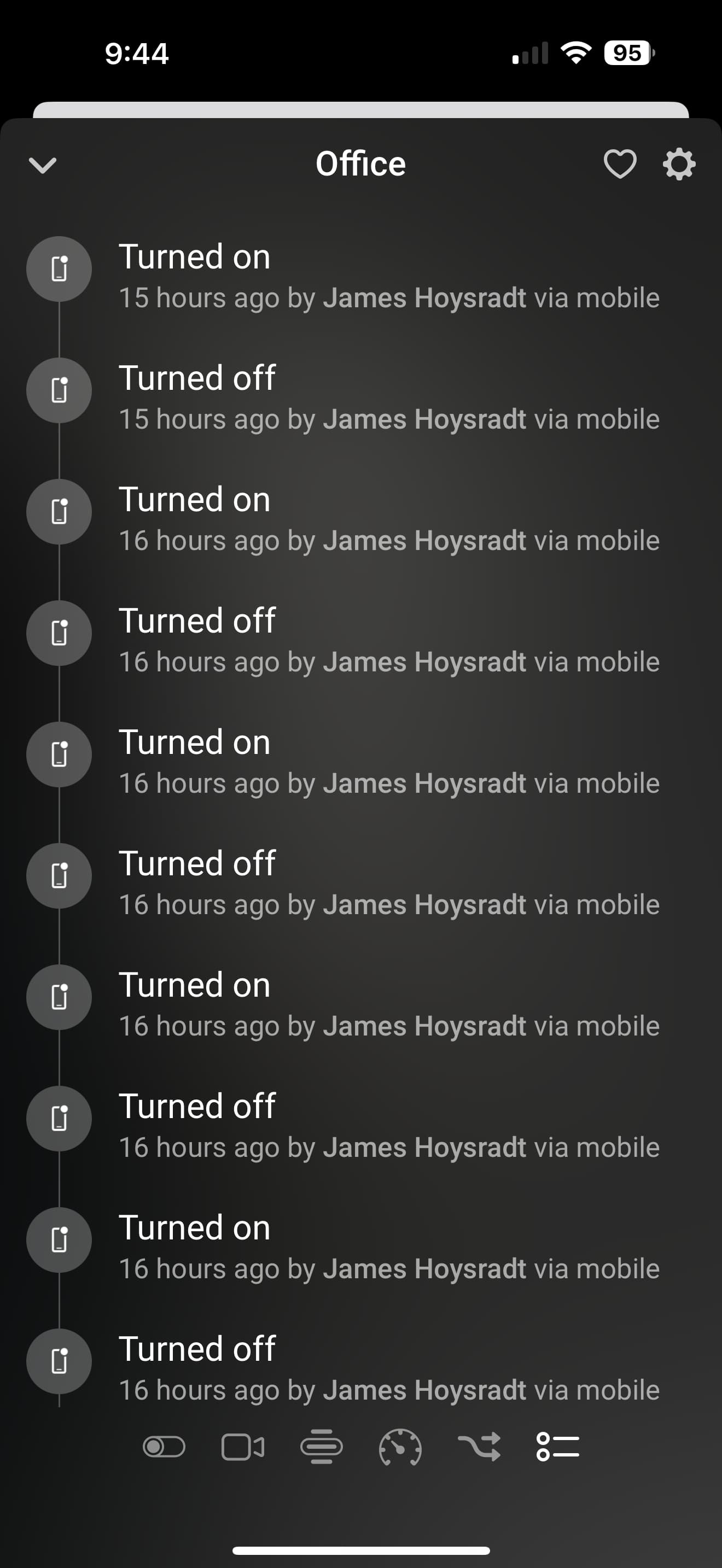

Have bunch of eufy cameras…indoor pan and tilt, outdoor eufycam 2, and indoor cam 1080p. I was able to successfully add them to homey pro BUT they don’t seem to work with regards to motion sensing. I want to set up flows that when camera senses motion or a person or zone is active but none of those cards seem to work as they are not sensing any people/motion.
I have them in homekit and homekit is sensing the motion. Is this a flaw/limit in the app or a bug or did I just set it up wrong?

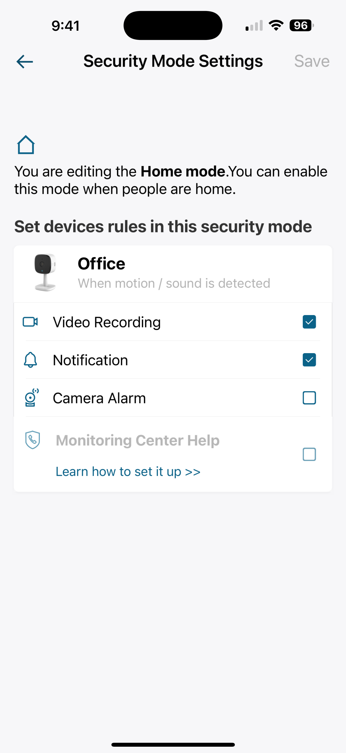

Martin, thank you for reply but I have done that already. I even logged out of my admin account and logged into the shared home account and set all security modes (home/away/disarmed) to allow video recording and notifications.
For troubleshooting ease, I am just trying to get one camera to work, and it isn’t bound to a home base…and still no luck.
I know Eufy just updated their app so is that an issue? I am completely stumped on this. I get push notifications from the app on phone, but nothing registers in homey.
@Goshawk29 please restart the eufy app in homey and send a diagnostic report after that
