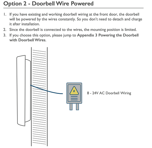

Luckily Eufy support 8V - 24v for the Battery doorbell.
So a dutch standard for doorbel adapters (8V DIN-rail trafo) will be sufficient and also allows the use of the existing bell.
I have setup this for more than a year and works flawlessly
See below a screenshot of Eufys 2k Battery Doorbell manual.
Thanks!!
Is 8V sufficient to charge the battery AND check the surroundings, send images etc.? Or is a higher voltage needed for that?
I don’t have an existing chime. Can I still use the adapter to charge and will pressing the doorbell not result in a short circuit of the adapter?
Yes, it’s sufficient. Normally al functions work on battery only and every once in a while you will charge the battery.
What is basically does is slow charge the battery of the doorbell so it’s always full.
I’m not sure about the short circuit, because don’t have that situation.
But if you set the doorbell up they ask I think if there is any existing chime. In your case that’s not so this should be disabled by Eufy. I think just as you set the doorbell to off in the app. So there will be no pulse send. But then again, this is my opinion.
