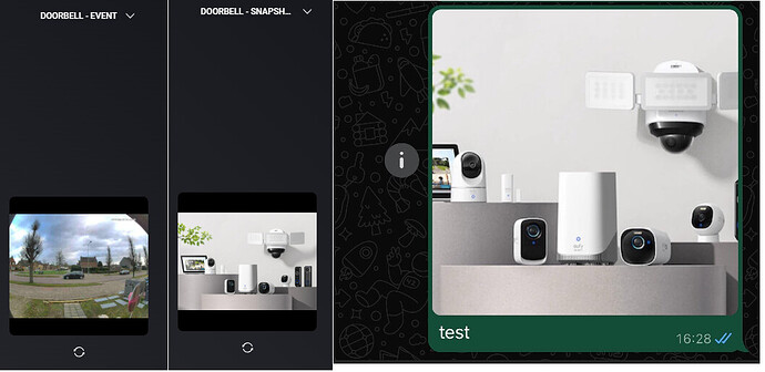

@Sander_Muurmans i saw a succes in the log and it set the snapshot
You did check the dropdown in the device? There are 2 images per eufy device

I just restarted the homey and tried again. Same result.
New diagnostics report:
aa3a3782-4f36-49e9-8fe4-26d26b70b2f2
I am aware of the dropdown menu.
I have never seen any image returning from the snapshot. The events do seem to work fine.
@Sander_Muurmans I see no issue. in your log the snapshot is updated and should be there. However i do see you refreshed a lot of times. but as far as i see it should show up now. However i think when you send the report that was the time it updated.
Very weird that the log / diagnostics report tells you that it is updated, while in reality, it is really not. (you can see the previously attached image?)
@Sander_Muurmans i can’t see the image only a confirmation of the update and I see that the steam opens and closes. So I can’t do much here
What would be the next step in order to try and debug/solve this?
@Sander_Muurmans i have no idea
All looks good so there’s nothing to debug

What I mean is that earlier in the Eufy app I could set it like WHEN the doorbell is ringing THEN play doorbell via Sonos (that works) and also send a push notification to a specific user with the snapshot the doorbell took of the person ringing.
Probably the fault is on my side, as of now I have a THEN card that says "Take a snapshot (use selfhosted service). What service should that be?
