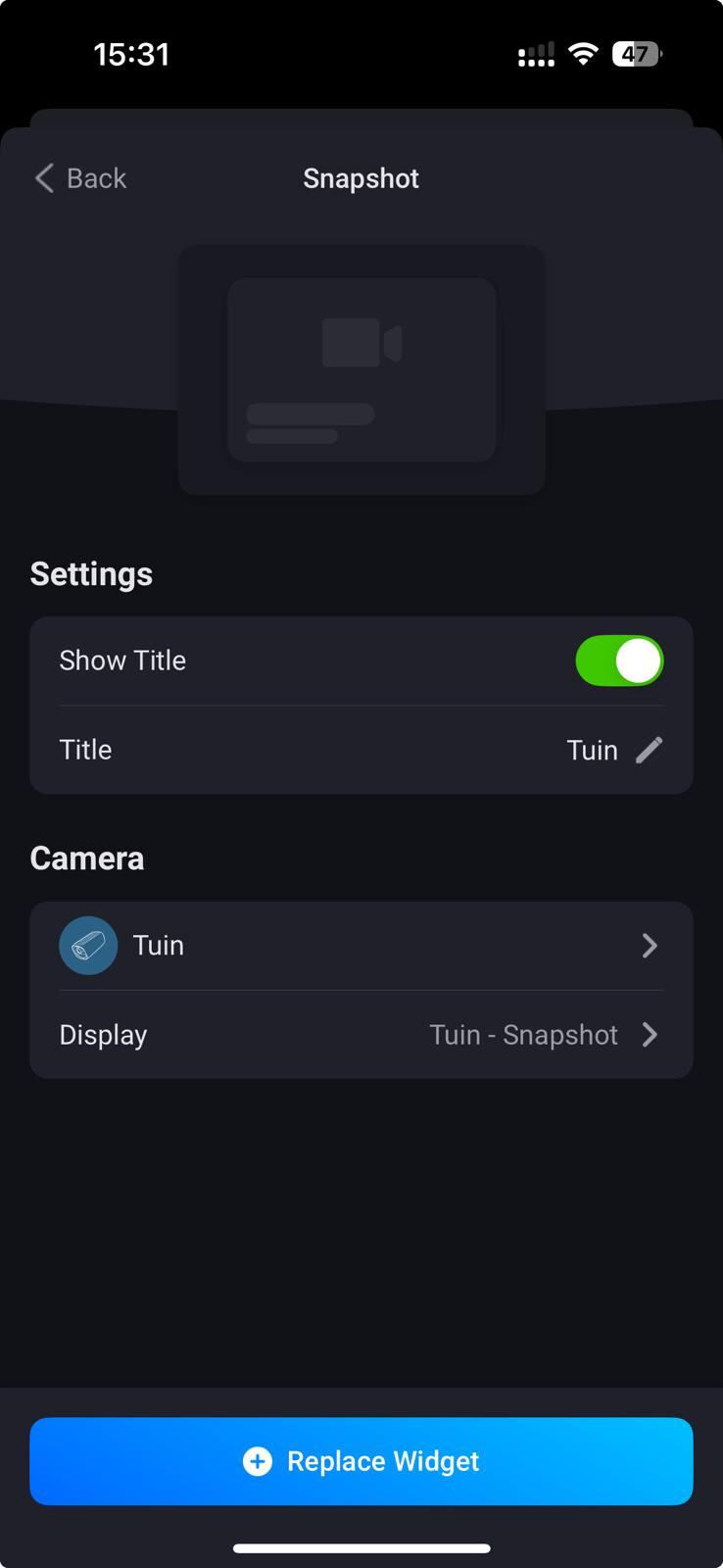

I have eufy indoor 360 camera. I want to have snapshots from this cam on my dashboard. I can see snapshots from cam directly in the device, but on dashboard there is always event picture.
Can I somehow set that cam will be always showing snapshot on dashboard?
Thank you!
@Jan_Vitasek yes select the snapshot image in your dashboard :slight_smile:
select display and check Snapshot

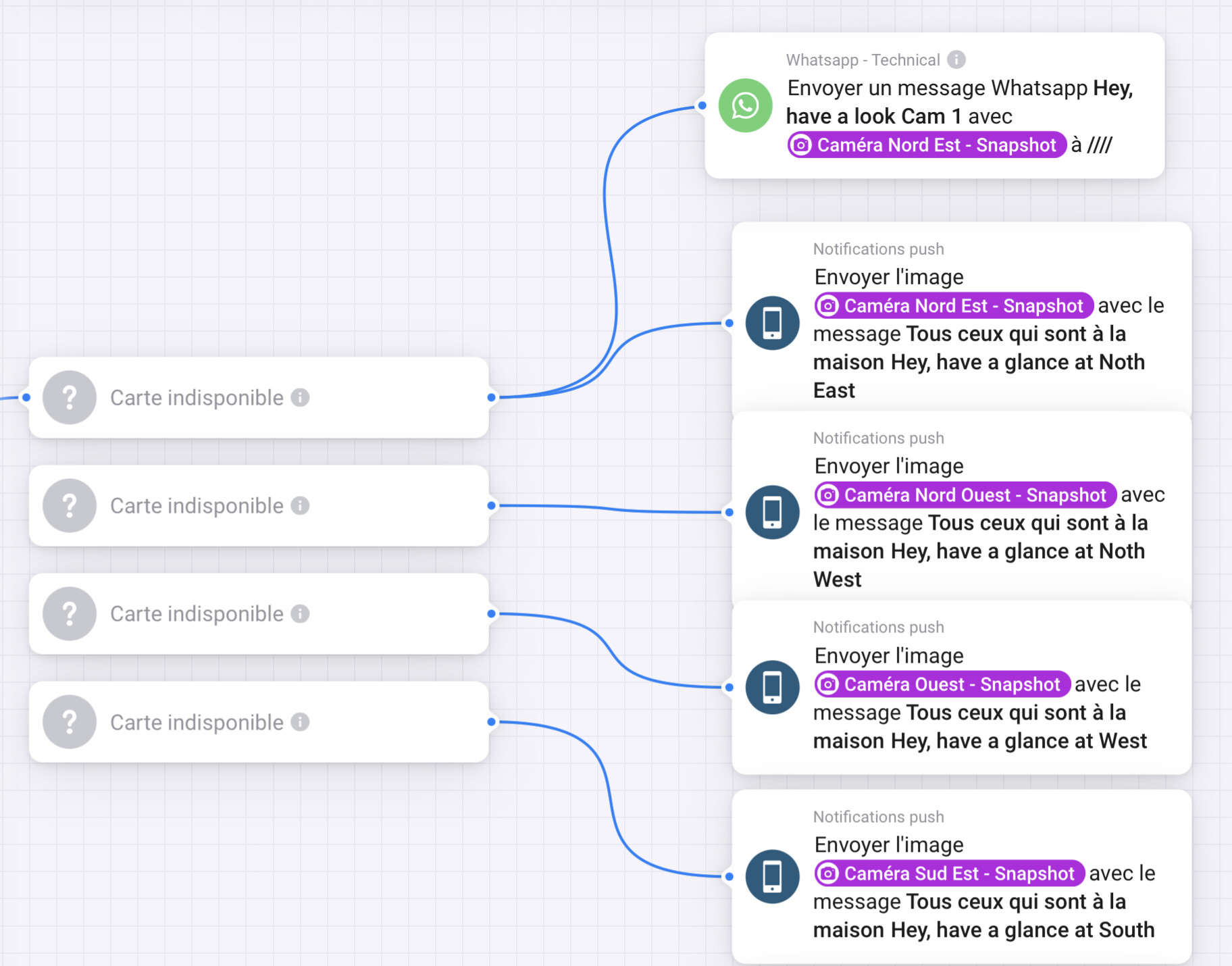

I did uncheck the Performance (beta) to standard in Eufy App, then it works couple of times with Homey notification, but not by refreshing button on devices pages, neither trough WhatsApp.
Then nothing after 4-5 tests.
c4e1fd6c-1ca6-40b9-b7ef-bed3994556ce

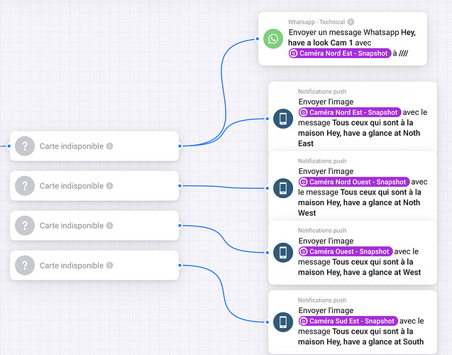

@Davi-d are you running the flowcard for snapshots? As I see you’re only refreshing the image, but that won’t take a snapshot
If so please run the flowcard and send a new report
Workin couple of second ago by using a flowcard.
But only the door bell is workin, all camera are displayed as card unavailable when they appear correctly in the devices list.
a83e4202-9c2b-4547-9286-c6853e343a80
Now they appear again in the flows
@Davi-d yep probably the app crashed. I’m still waiting for a fix from athom for HP23. → Upgrade OpenSSL to 3.2 in favor of Eufy Security · Issue #375 · athombv/homey-apps-sdk-issues · GitHub
But next to that opening 4 streams at the same time will definetely not work.
Make sure to put 4 seconds in between the different snapshots. Eufy can’t open multiple streams at once. That doesn’t work in their own app either
Get it, they are all together but I just click on test from here.
I did stop asking to get 4 snap at the same time since former feedback you provide me couple of weeks ago.
