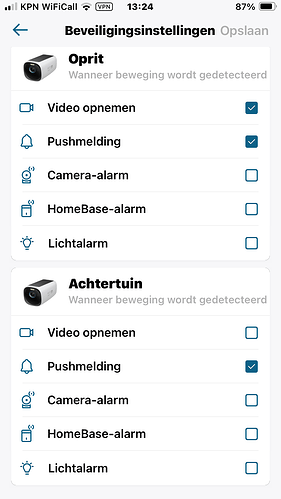

These are the settings I use since I installed the camera’s (I think two years ago)
