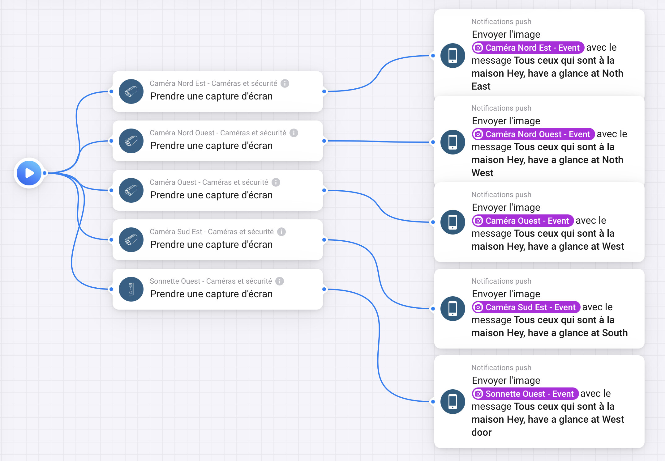

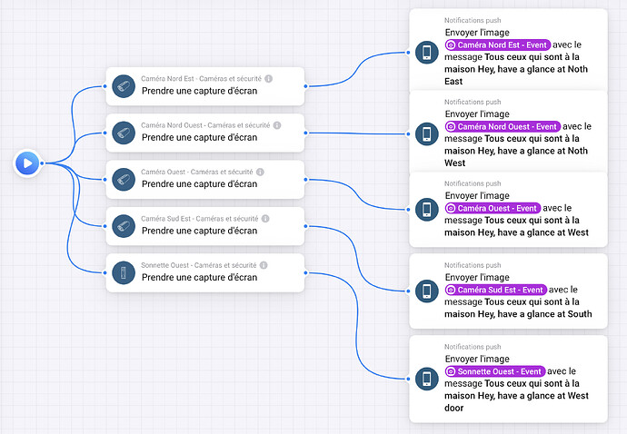

Then since my last post on this tread couple of weeks ago now, I did a lot of tests with the Eufy App.
I did follow precisely you FAQ, restarting from scratch several times etc.
It still does not work perfectly for now :
  • 1 All snapshots always provides default Eufy image
  • 2 Events are working but most of the time not the last events is displayed but older ones. Sometimes very old ones.
Here is my main lead trying to solve the issues :
1/ For the meantime using same ID / User in both Eufy App on my iPhone and in Homey or different ones doesn’t make change.
So my first question to try solving this issue in particular is :
  • When adding a secondary account should we use : Shared Home or shared Device ? Does this choice make any difference ? I tried both…
Notes : I have the HB3, 4 cameras S330 and 2 video Doorbells E340.
I use these simple test flows to make tests since I can’t includes them in working flows for now.
Here is the diagnostic key : f1a4fcb8-774a-4715-a806-f16028ea97c1
Let me know if I can help by any way.
Best,
David
Hey… I’m trying to make a flow wich will make a snapshot - I have read the forum here and tried to restart the app and also the homebase. I have S330 cameras. One time I had it working - but now I can’t get it to work again…
fddf1357-a700-4492-a412-5c247da12ef3
Can you see if i’m doing aynthig wrong?

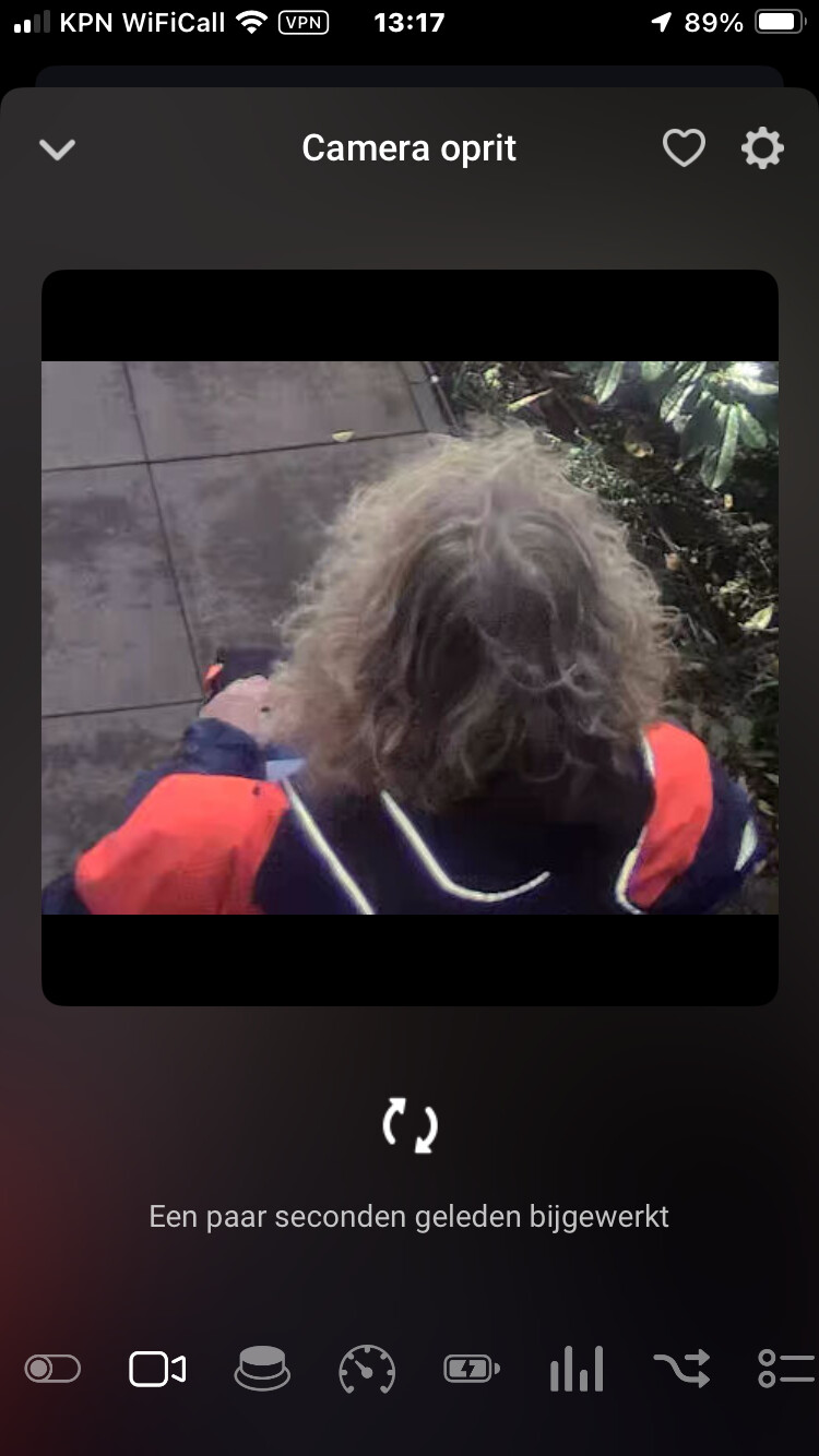

On December 2 I switched to the 2023 (with a backup). Detection of the Eufy S330 worked until December 3 but has now stopped. What else do I have to do? After restoring the backup, I logged in again to my second Eufy account.
In the app I get a snapshot but I had to renew it manualy.
