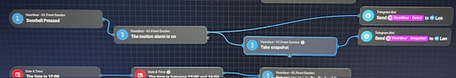

Hi Martijn. When i use the flow for sending a snapshot and event when the doorbell is pressed via Homeybot (telegram) i get two messages. One of the event which is correct. And the snapshot is from when the doorbell has been pressed earlier (e.g day before) so allways one picture is not accurate. Does it have something to do with the app or because of Telegram. Can you please help?

@Lennart_Peereboom sounds like you made a flow where it send the event and snapshot image both. While the event image is not updated
Sound look a flow issue to me
Hi Martijn,
Thanks for your reply. Hearby is my flow
@Lennart_Peereboom please read FAQ Q3 - A3 that also explains why the doorbell images doesn’t show a image: [APP][Pro] Eufy Security - #4 by martijnpoppen - Apps - Homey Community Forum

I’ve edited the flow and send a text after the event and snapshot. The image of the event is the correct one and will be updated after a doorbell press. When my flow says to make a (new) snapshot after a doorbell press, i get a image from a doorbell press before the latest doorbell press. Every (then) action will work unless there is motion detected and than the event works correct.

@Lennart_Peereboom sorry im really confused now. Which image is not working like you expect ?
Btw if you select text in the forum you can quote text. Instead of copying my message :wink:
