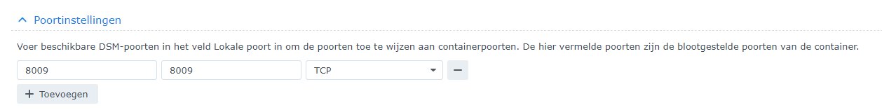

Hi @martijnpoppen, I’m still having problems with the self-hosted snapshots.
Just when I think it works because I see real images, I am then shown the standard Eufy picture again.
This is for all the cameras and doorbells I have.
Snapshot to the cloud does work but are old images. :woman_shrugging:
After previously using port 3000, I now used the port from your example 8009.
NAS firewall on or off makes no difference.
Both port 3000 and 8009 are port forwarded in the Ziggo modem to the IP address of my NAS.
In the image below you see two different port setups in Docker, but both have the same problem.
When I take a snapshot to the cloud it seems to trigger something that ensures that I seem to get the right images again. I say seems because the snapshots that go to the cloud are old images and they are therefore sent via the self-service snapshots.
In any case, something is not going well with snapshots to the cloud and with self-service snapshots.
Any idea what’s going wrong or what I’m doing wrong?
Previously you indicated that the URL I used was incorrect, but that is the IP address of my NAS and the port I used at the time.
Now I have set the URL this way because I changed the port to 8009 as in your example.
Capture_1155
Thank you.
Hi @Heula As said in Q13 im not giving support on the self hosted snapshot feature.
I created it so users can set it up themselves. But i already have a lot of support tasks on all my apps.
also make sure to check Q13, because it mentions which port you need to map (Q13 - A3)
And I indeed said previously that the url was wrong. At least Homey couldn’t reach it.
