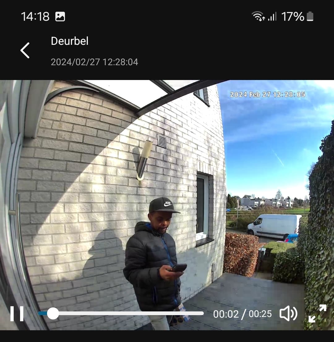

In the doorbell on Homey.
Screenshot from original Eufy app with last doorbell event.
Image from that is also uploaded to whatsapp and that is where I see that is not good.
How I see it in whatsapp.

Looks like the stream isnt started. A restart of your Homey and/or Homebase might be the fix. Not sure
Both tried no luck ![]()
Installed the stable version (not-test) same issue ![]()
Just came home, snapshot and event image are different. Event image is the same image as posted above.
