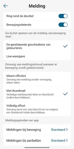

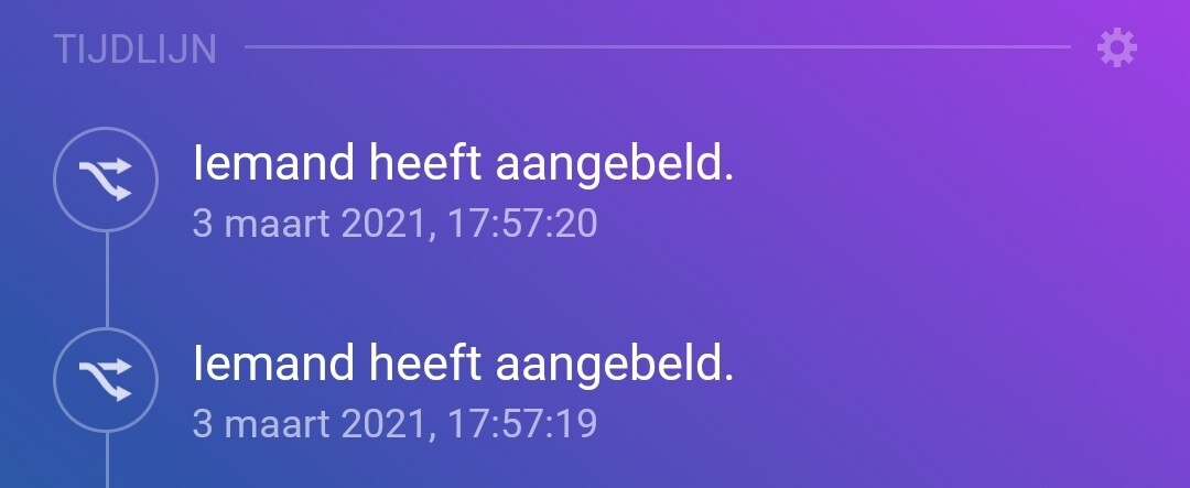

For me unfortunately it is not working properly. It doesn’t give movement updates (i’ve setup notifications in the 2nd account I made for the app). Also it gives double notifications for pressing the doorbell. I’ve already tried clearing and reconnecting, restarting the app and homey etc. Also it only makes a snapshot once in every 4 or 5 times that the doorbell is pressed. Do you know what I’m doing wrong?

For the notifications you can check this message: Eufy - #518 by martijnpoppen
Make sure you have movement enabled in youur Eufy app

New app update (test: 1.11.9 ):
  • FIX: duplicate notifications
New app update (live: 1.11.9 ):

Hi @martijnpoppen,
I have tested the version 1.11.11 and there are no duplicate notifications anymore.
Thank you very much!

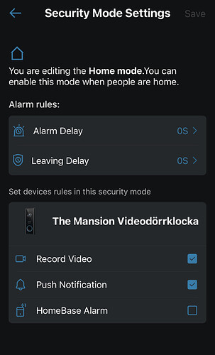

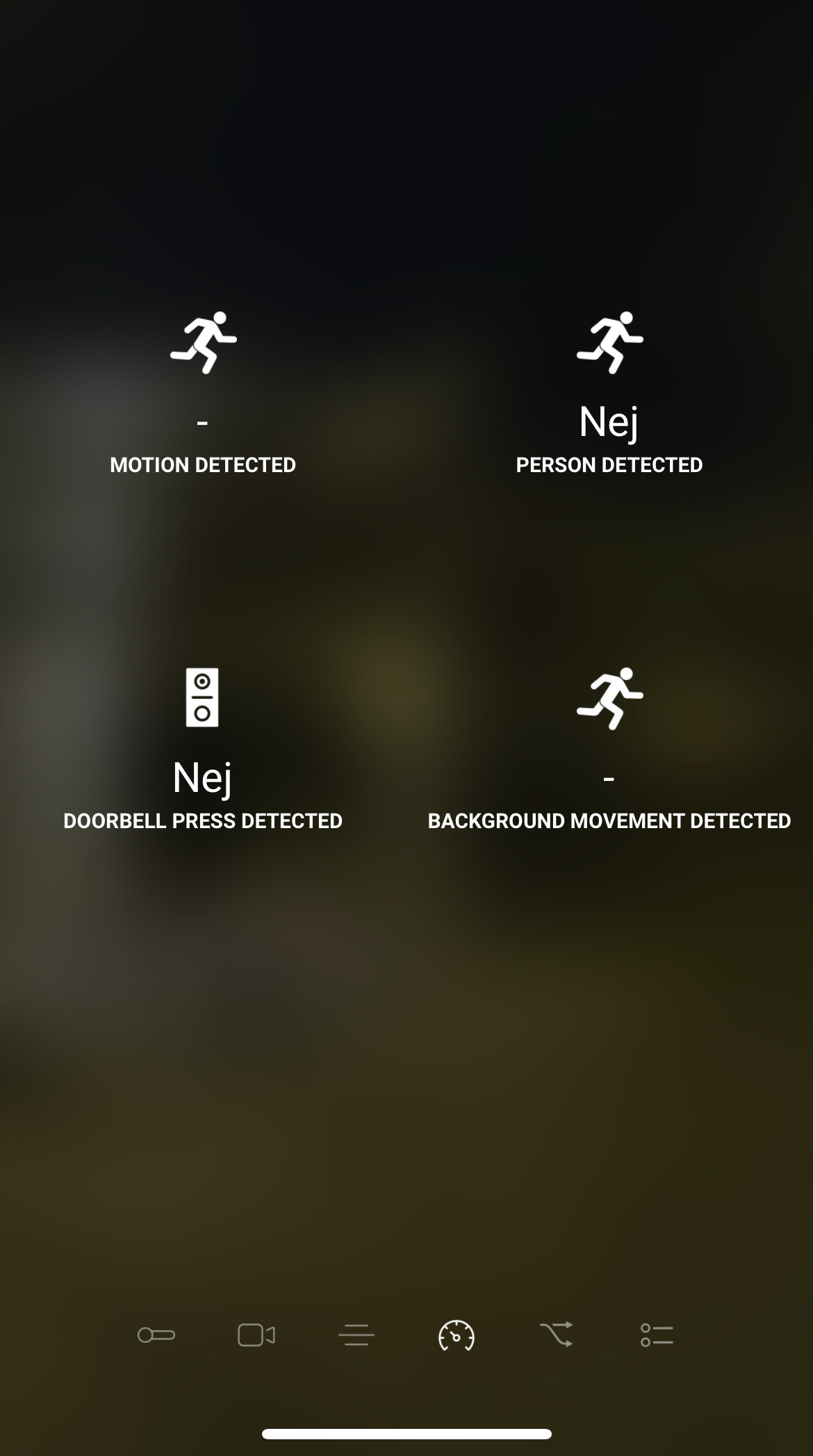

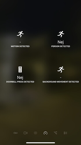

Hi, again! Would love to get the app working but can’t figure out how. I’ve set everything up, I just reinstalled the latest version of the app, added my 2k wireless camera again. But it doesn’t register motion. When I press the button, the app registers it and triggers flows. But nothing happens when motion is detected and the image below doesn’t update to show that motion has been detected. Flows don’t trigger. The eufy app itself detects and can send out notifications. It doesn’t matter if I have notifications turned on or off in the stand alone eufy app. Any ideas as to why it’s not working?
Hi @Crowntwig ,
I just discussed this with @Avi_de_Winter. There we found that the issue was that the security mode didn’t have this enabled.
Make sure the Push notification is enabled for the selected security mode.
Hope this helps! :crossed_fingers:

Unfortunately not, notifications is on but it still doesn’t work. Well, it works on door bell press, but not for motion detection.And my settings page looks slightly different.

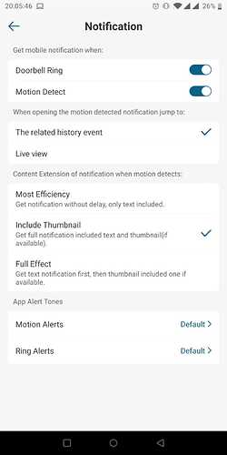

@Crowntwig Do you have the Home Mode enabled?
Also can you check your notifications tab:
