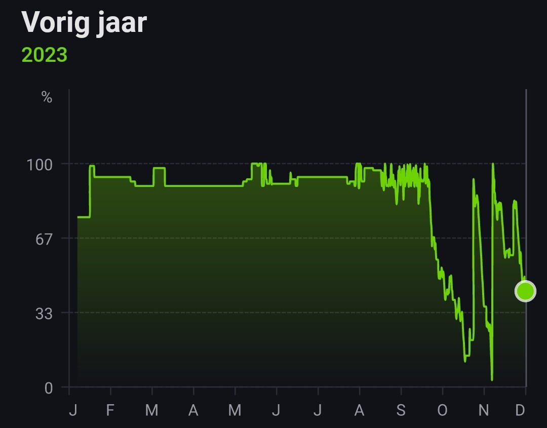

I have multiple Eufy cameras around the house including a battery dual doorbell. I do have it wired using the cables of the old doorbell. However, the charge drops insanely fast. According to the Homey Energy Insights it was 100% on the 5th december while today there is 16% remaining. When I check the Eufy app it most of the time shows the plug icon (which I guess means charging?) Is it a possibility that Homey is constantly trying to pull information (or something else) which impacts battery life? I have the camera for about a year and the issue wasnt there at the start.
Thank you!
Edit: I just checked the battery life in Homey over time and it seems like it started to go empty very quickly since October. Any idea if that could be Homey related?
