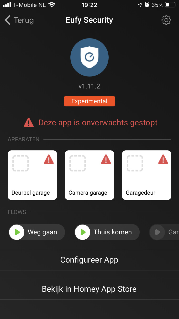

@martijnpoppen, I tried to add the door sensor in test version v1.11.2 but the app crashed. After restart it immediately crashes again.
Before I tried to add the door sensor I removed the old door sensor which was listed as a camera.
In attached picturee ‘Garagedeur’ is the door sensor.
@Hans_Festen ,
I See, made a small mistake. Will update in couple of minutes
@Hans_Festen version 1.11.4 is now available
