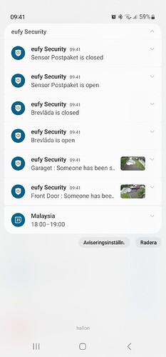

I have turned off notifications from Eufy in Android settings, since I don’t want a notification every time one of my 12 cameras see me walking by :wink:
@ExtraKim oh haha, but are you able to verify that ? :slight_smile:
Because if Eufy doesn’t trigger homey would also not trigger it
I turned on notifications in Android, I got six notifications just going to my mailbox and opening and closing it… :smiley: With other words, Eufy are getting the notifications.
