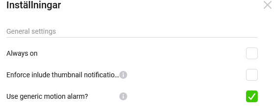

My door/window sensors have stopped working in Homey. I had it up and running and now I can see that it hasn’t updated in the Homey app the last nine days. If I look in the Eufy app the sensors work just fine, when I run the flow manually in Homey it works just fine. I have restarted the Homey and the Eufy app in Homey, didn’t help. I have clicked on “Repair” but it didn’t work.
My cameras work, both the solo cams and the cams that use the Homebase 2.
@ExtraKim make sure your push notifications are enabled see [APP][Pro] Eufy Security - #4 by martijnpoppen - Apps - Homey Community Forum Q1
Will check @Peter_Kalrsson
I haven´t changed anything in the settings. I use 3 different Modes “Away”, a custom called “Daytime at home” and a custom called “Night” all of them has notifications on for the sensors.
Is this right in the settings?
