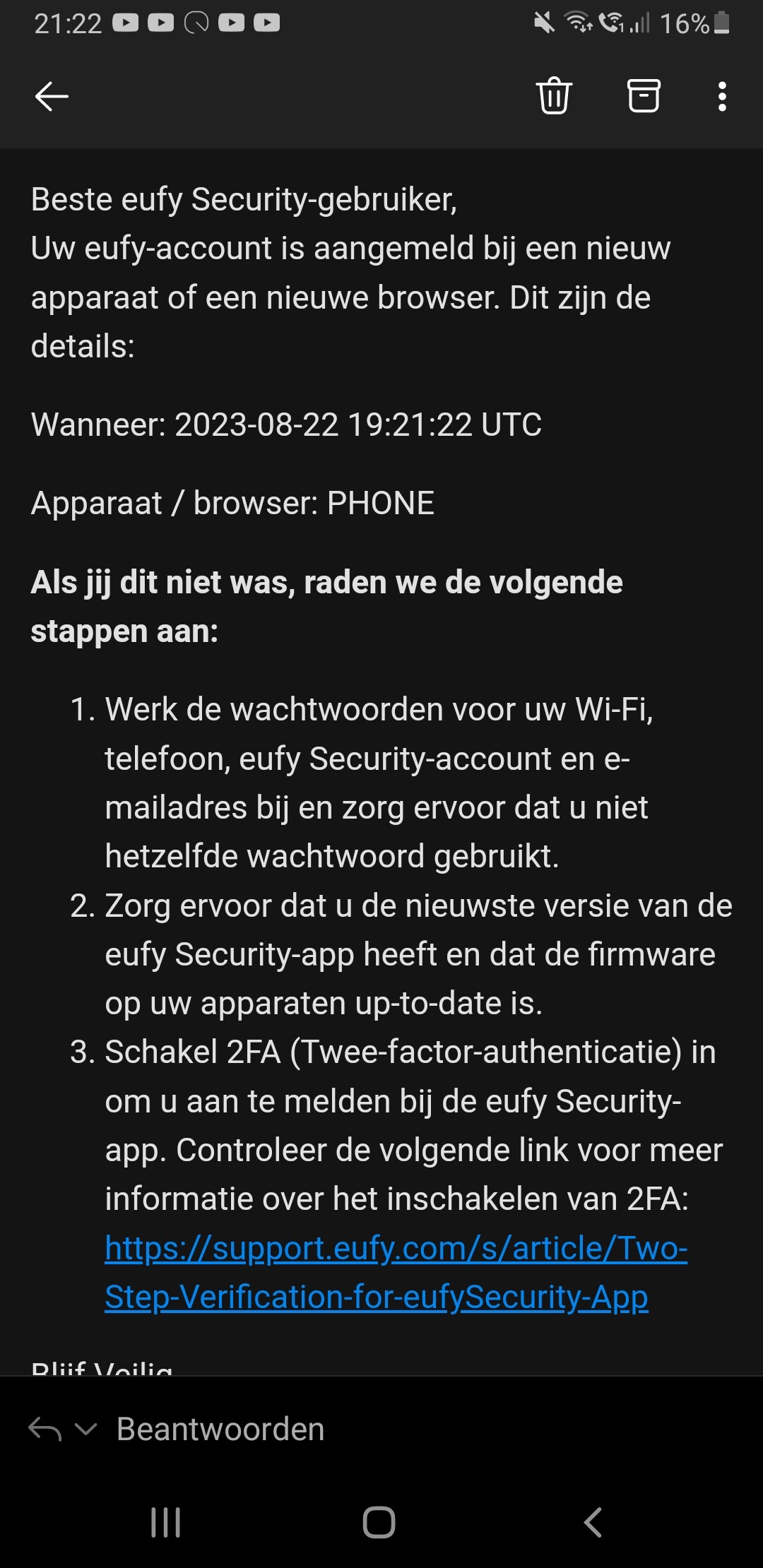

Hi there, did the app login again after the update?
@Glenn_Dijkstra on every start of the app the app logs in. So also when theres a update. Never saw that email though
thx for the quick reply, i ll search a little further
