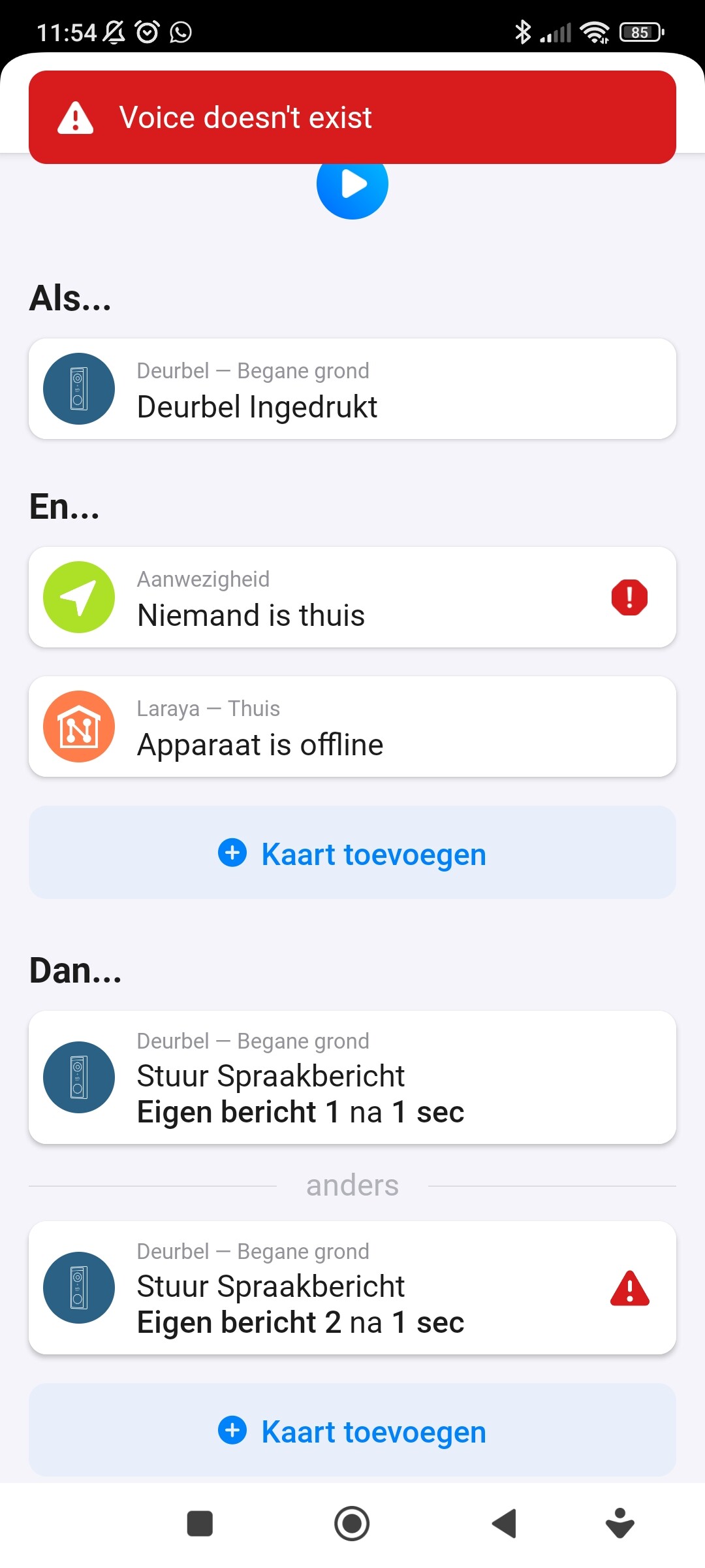

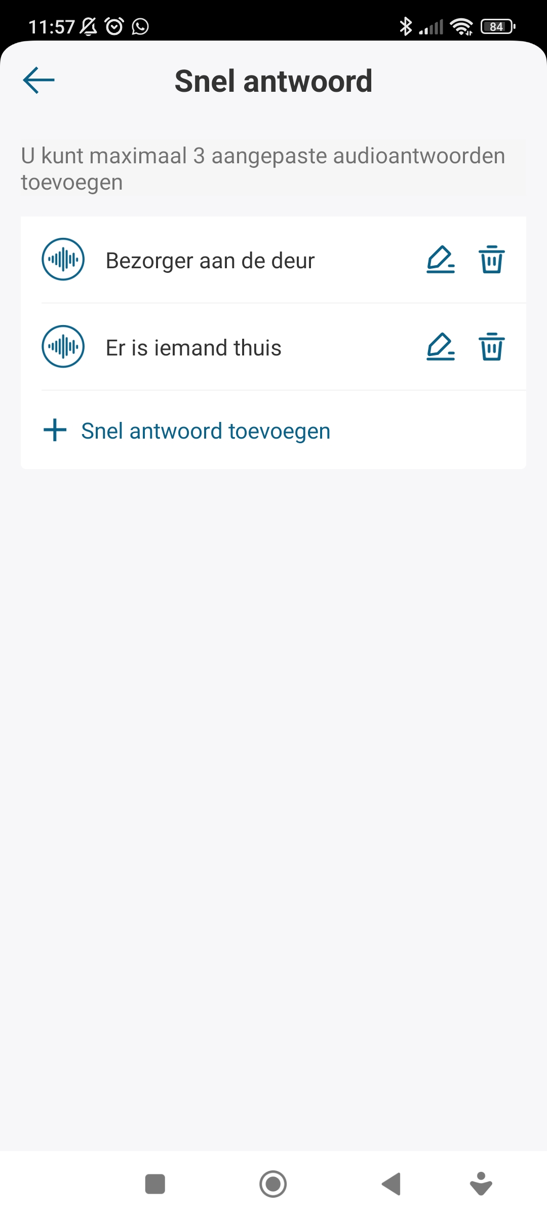

@martijnpoppen I’m still struggling with the voice prompts. Sometimes it works, sometimes not. Now I also het an error: voice doesn’t exist. But I really do have two different voice prompts. Can you help me? Here is a diagnostic report code: d67a4955-a427-4e30-ae44-c83146d1c136
@Borskietje I would suggest to restart the app and see if that resolves it :wink:

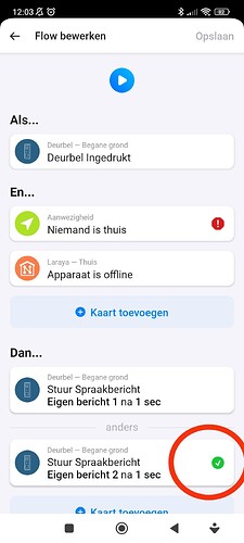

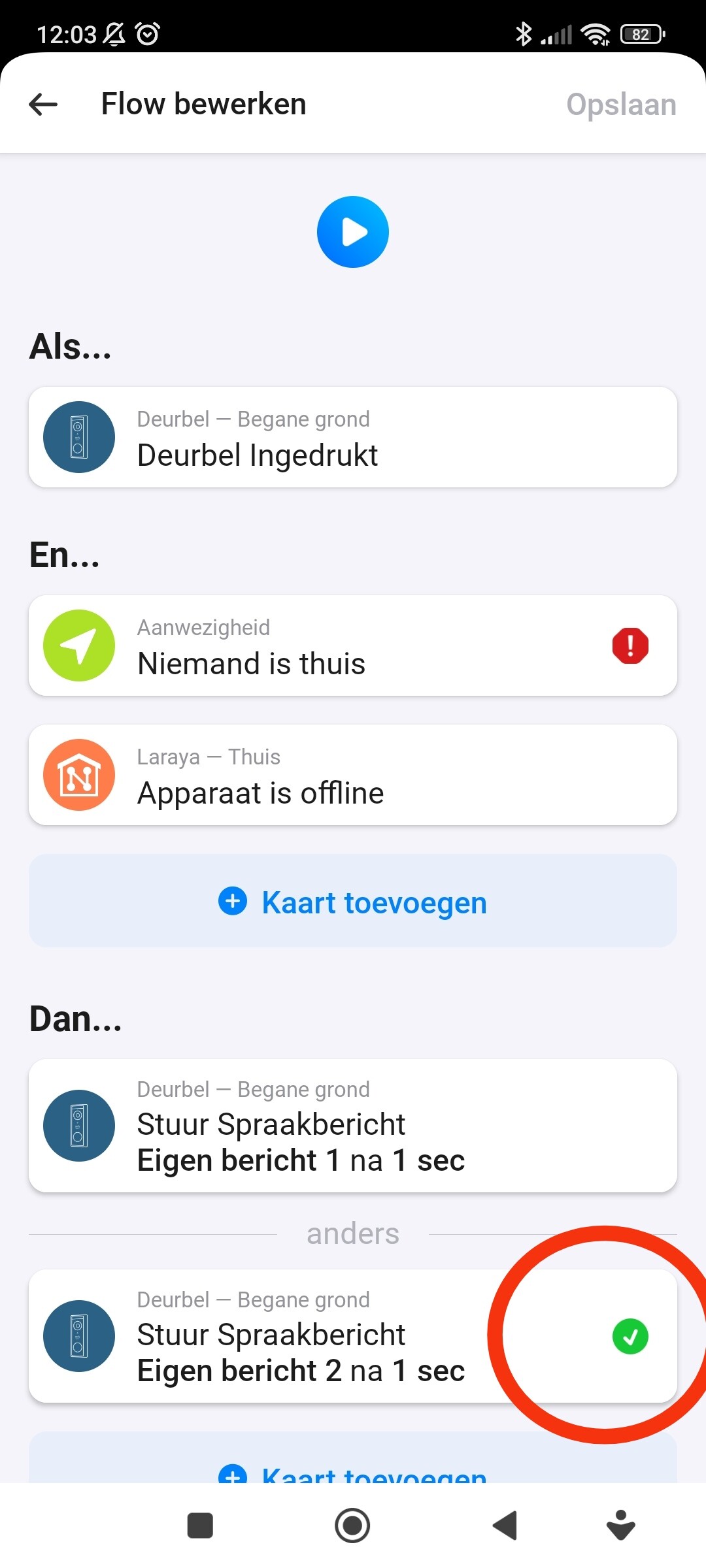

I just did. The second voice prompt is now recognized by the app. However, the push action to the doorbell doesn’t work that well. I just tried to test the flow, and the check-mark tells me it has send the voiceprompt to the doorbell. However, the doorbell doesn’t play any voice prompt. Here another diagnostic report code: 0c6c0fcf-5b08-4efb-8ecf-be0a01baa877
@Borskietje all looks good in the logs. The doorbell never reports back if it did something with the command, it’s one way communication.
The voice reponse are not always that stable. Especially when you try a lot after each other, then at some point the doorbell just ignores it to save Battery
