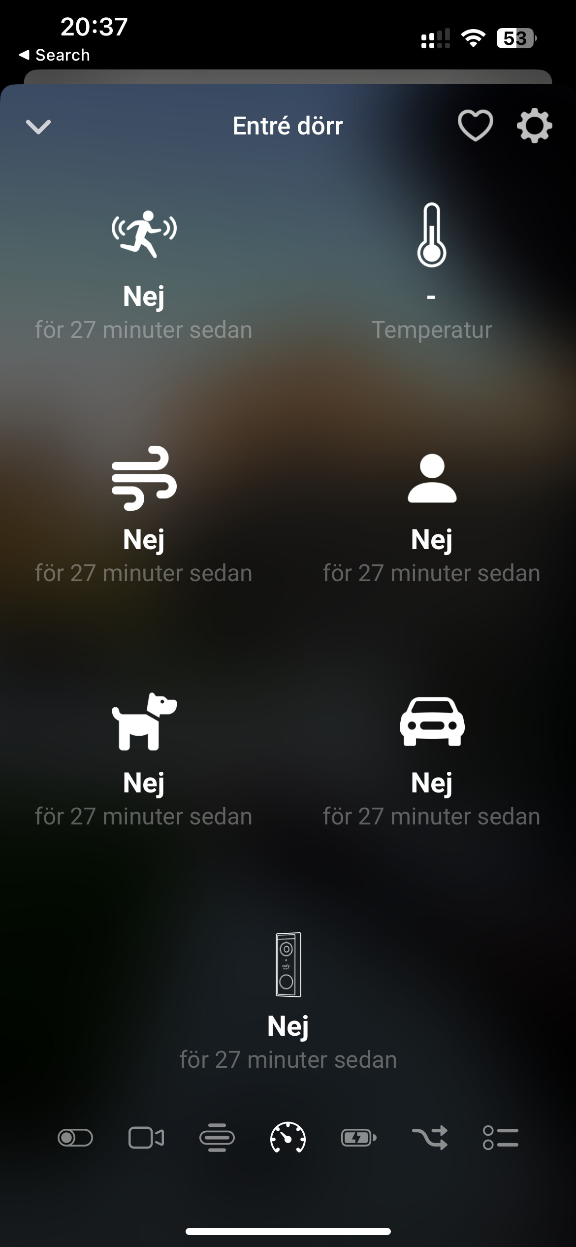

I have eufy dual doorbell, It doesn’t register any motion/ person / pet etc
I have tried to repair and installed the app without any luck. I know that homebase 3 is working fine because I can make it change security mode via homey eufy app.
@Goliath if you just paired the devices then i would suggest to restart the app.
Theres a bug which doesn’t start the events after pairing :frowning:
Thanks for a prompt response. Do I need to activate something. I have restarted the app and still the same.
I looked now on my other cameras and they have not register any activity since 6 days ago

I see! I enabled now notification in the security mode that I’m using now. I can see that the image is taken but still no motion detection.
@Goliath can you send a report when theres motion? :slight_smile:
8d843ccd-e554-4551-bceb-d85169870994
@Goliath thanks
I do see the events coming in but they are not registering.

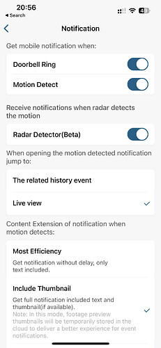

What notification style do you have selected on the doorbell?
You can check that in the doorbell settings and then notifications
This is what I have:
@Goliath that looks correct. Does doorbell press work? :thinking:
Yes the doorbell press got registered. Says now a few seconds from last time
